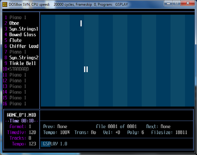

The HOME_001.MUS file is a library of song files that can be extracted using a ripping tool that understands standard MIDI format. I found that the 21st song file is the game's MT-32 intro music, and playing that in a Windows MIDI player shows 123 BPM, so the game does not seem to be using that in error, and the music does indeed play a bit faster than in DOSBox.

Reply 10 of 35, by sndwv
Awesome. For completeness sake I've attached recordings of the extracted .MIDs, played using GSPLAY in the exact same DOSBox environment the games were run in. GSPLAY plays them back at their correct (faster) speeds, same for Eric the Unready, which I can confirm has the same issue of being too slow when played by the game engine.
