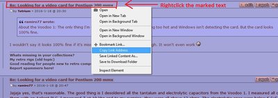

Reply 144 of 162, by gdjacobs
There's lots of good info in the Capacitor Replacement thread. I added an equivalent circuit diagram so folks can discuss capacitor behavior and properties a little easier.

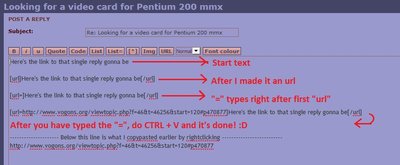

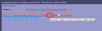

Reply 145 of 162, by Tetrium
k, here goes:
    103.97 KiB
    583 views
    step 1
    38.17 KiB
    583 views
    step 2
    88.65 KiB
    583 views
    step 3

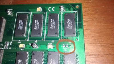

Reply 151 of 162, by PCBONEZ
Thanks for the tips on using Vogons guys.
Very helpful.
ramiro77 wrote:
Yes, of course. It's labelled C104 near the vrams:
228.92 KiB
485 views
I have identified the caps on this Voodoo board as G-Luxon SV series.
The giveaways are that before 2005 G-Luxon were the only ones using black *and* that marking convention (arrangement) *and* had a series code "S" *and* the series dates back into the 90's.
G-Luxon and Teapo merged at the end of 2005.
Before the merger they both had an SV series but Teapo's were radial and G-Luxon's were these SMD parts.
After the merger they retained the SMD part and the radial part went away.
The SMD part is still shown as a current product on Teapo's site, although I personally would use better caps.
They are not low ESR (and IMHO should be) and their Endurance rating is only 1000 hours. Not a long-life cap.
Datasheet here: G-Luxon_SV-Series_PDF
Keep in mind these are GP caps and the datasheet was done at 120Hz.
Getting the data from Teapo is problematic because they put it in one huge PDF that covers all their caps series.
Some revisions are over 190 pages long.
