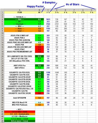

Reply 32 of 55, by PCBONEZ
dr_st wrote:
That's OK. If you go by personal experience of failing boards, you will very quickly end up with bad opinion on all manufacturers, with no exceptions. 😀
My personal experience of failing boards is something over 2500 boards and I think Asus boards made since 2001 are crap.
There are exceptions but for the most part they used cheap caps, too thin of traces, cheap MOSFETs and VRs, and insufficient EMI/protection/stability components (SMD).
And they are picky about RAM. It's not the RAM it's that the board can't keep the voltage to the slot stable and load tolerant.
Their customer service went to hell about the same time.
Before 2001 (vintage) I thought highly of Asus.
And no, i don't have a bad opinion of all manufacturers nor do I have opinions that ignore the vintage.
I used to use this in my signature: "Friends don't let friends buy Asus."

Reply 34 of 55, by dr_st
That's a lot of boards indeed. Enough to collect meaningful statistics. Did you happen to collect such data? Would you say then, that the percentage of failures among ASUS boards noticeably exceeded their percentage in the "general population"?

Reply 37 of 55, by PCBONEZ
dr_st wrote:
Not the kind of statistics you want. - And I don't do any formal studies for that.
I see them after they have problems so what matters is -what- problems they are inclined to have.
Most brands need nothing more than caps but Asus are a cans of worms.
I have a P4P800-something on the back burner now with a burned a trace to fix.
Also a P4C800-something but I don't recall what it's 'extra' problem is.
Probably 1/2 the MOSFETs I've had to replace were on Asus and Asus is no where near 1/2 the boards I see.
Asus are more likely to stay dead after a recap (when caps are the only evident problem) than other brands.
I can also tell you that Asus continued using cheap Ch/Tw caps from 2001-ish all the way until their transition to all polymer.
In my opinion even if they had no other problems that makes Asus a low end brand.
When you see a board with "Premium" or "Deluxe" in it's name and it has OST caps on it someone is lying.
In contrast Abit and Gigabtye were quick to adopt Japanese caps and I think MSI eventually did. (Meaning adopt Jap before all poly.)
Intel, Dell, Supermicro and Tyan did. Jetway, Soyo and EVGA did not. I am not sure about HP, Biostar or Foxconn.
Some of these companies got screwed by using Nichicon HM/HN which are Japanese but were defective from 2001-2004-ish due to a manufacturing problem.
(Or Chemicon KZG/KZJ which are Jap but just plain unreliable.)

Reply 39 of 55, by PCBONEZ
dr_st wrote:
I think this is more along the lines of what you want to see.
I do this sometimes when looking for something for my own use.
I call it the "Happy Factor". It looks at how happy the buyers of the product were.
What it does is gel the reviews down to one number so it's easier to compare multiple products.
Also (by # of samples-reviews) it gives a rough indication of how many were sold relative to each other.
This one focuses on motherboards with a P35 chipset.
By creative use of google you can find all such boards listed at Newegg and it shows the total number of reviews.
(It works for any site and product but Newegg is easier than others and motherboards are pertinent.)
I chose only those with 75 or more reviews. I usually use 100 but I wanted more than one MSI included.
(FYI, below "#4stars" means "number of 4 star reviews".)
The Happy Factor = (#5stars + #4stars + #3stars/2 ) / ( #3stars/2 + #2stars + #1stars)
- In the chart:
The top portion shows the totals by brand. The individual scores are below that.
The key is at the bottom.
The cutoffs for good/bad etc were determined by inputting motherboards I know well to see their HF score.
161.7 KiB
974 views
