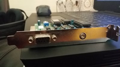

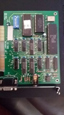

I have a 8 bit data soft ISA midi interface card but i lost the jumper setting
would any one have them? so i can put it in my 386dx40 i am currently rebuilding
cheers
heres what it looks like

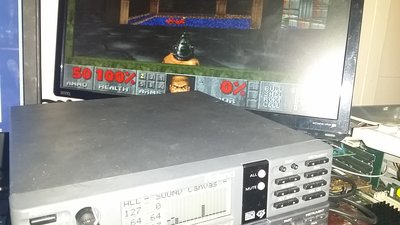

Reply 4 of 17, by latenite_tellie
Update
i put the card in my Pentium 200mmx build with windows 95 running took out the sound card
windows detected it as a mpu-401 compatible card at IRQ7 and base at 332-333
hooked up my sc-55mkii and ran the Duke3d setup ant tested the music i got music then if i test it again it would freeze
had a look for any conflicts Printer port was using IRQ 7 as well i changed it
i then tried running doom it didn't detected it even at the command prompt the set up would freeze
so i played around withe jumpers removing and installing it from widows 95 until it go to base of 330 and IRQ9
Duke 3d would play in the set up but freeze in the game
Tried doom again it detected it and i had music but as soon as i quit and ran it again no music
my 586 build with dos win 3.11
i couldn't work out what the base and IRQ were wouldn't detect it at all
doom wouldn't detect it
Next i tried my Pentium 60 build dos and win 3.11 took existing sound card out
In Win 3.11 Duke 3D would detect it but no play any music freeze at the test screen
In Win 3.11 Doom will freeze at the doom splash screen
If i hold shift and go straight to the command prompt
Doom will work no problems but have to turn the computer off and on to get music to work after using it again
Duke 3D will detect it and play but if you test it again the set up will freeze and say could not detect mpu-401 have to restart the computer
690.45 KiB
1615 views
Working at the command line
Any thoughts?
so i do have an intelligent MPU-401 but it has issues
i think i need to source a new midi interface card any one have a couple they want to sell?

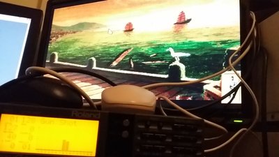

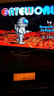

Update

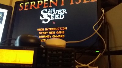

I've partly finished my 386 Dx30/40 (turbo) build
QD-U386DX 128k Cache
1Mb Tsang labs ET4000AX
8mb Ram
260mb HDD
No sound card will ad a CT1350b i just wanted to check the midi
loaded dos 6.22 only loaded a mouse driver and Smartdrv
i put the midi card in one of the 8bit slots
I checked using some dos utilities if there are any conflicts tho i know the base is 330 i do not know what the IrQ is as the utility is saying unknown at IrQ 14 ( i thought i set it at IrQ 9)
I've used my Sc-55Mkii as cant find my audio cables for my Mk1 Mt32
So far I've tried :
Warcraft 1
Dune
Ultima serpent isle 2
Heart of china
they all worked no issues yet......... Yay so far with programs .... just with some hardware aka the MhZ Led ....cant work it out so far
Any other Games i should Test ?

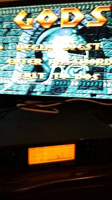

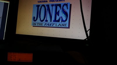

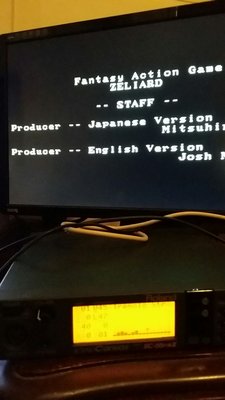

Reply 16 of 17, by latenite_tellie
I tried all the games except for Silpheed which i haven't installed
Jones in the Fast Lane
Gods
Gateway
Zeliard
All worked with no issues
I wounder Why it didn't work on my Pentium 60 or 586/133
