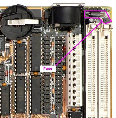

Hi all. I recently changed my CPU from a AMD 486 66MHz to a AMD 5x86 133MHz on my Tomato 4dps version 2.1 motherboard. I have Bios version 4.00A flashed and running fine. After I set the jumpers and booted my mouse no longer worked. It worked fine before and now nothing. I'm guessing maybe the mouse on the motherboard has died. It still supply's power and Ive tested with a optical mouse and it lights up. Is there a PCI mouse/keyboard card or something I can buy? Any help is greatly appreciated.

Reply 12 of 18, by PCBONEZ
Did you check the fuse?

Reply 17 of 18, by J3SteR727
Wow must apologize for my ignorance... Two of my PS/2 mouse wires were touching on the mobo connector. This was causing my keyboard not to work, Now with bios 1.72f everything works. Still would like to Flash to the Modded 4.00 bios if someone could please point me to the file. Thanks for all the help everyone...
