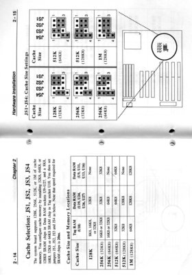

Installed is 256kb L2 Cache + 1 tag ram chip, according to manual (jumpers set correctly-BIOS recognizes the amount installed)
i tried 2 different Sets of Cache chips (20ns, 15ns) - both dont work. Also i tried 512kb according to manual, doesnt work either.

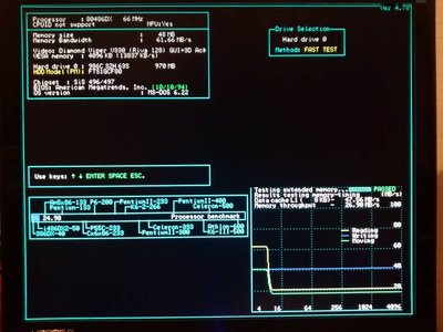

Yes it is exactly performing as if there is no L2 cache installed, even though on the BIOS post screen, it shows the amount that i set up with the jumper block.

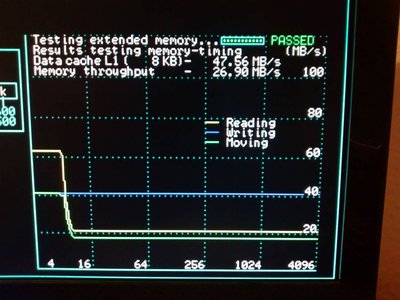

On cachechk it reports "it seems theres no L2 cache installed - check for fake cache"
On speedsys there is only one bump, in the region below 8kb (internal cache) after that there is a flat line. Also it mentions that there is no L2 cache.

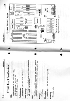

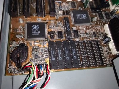

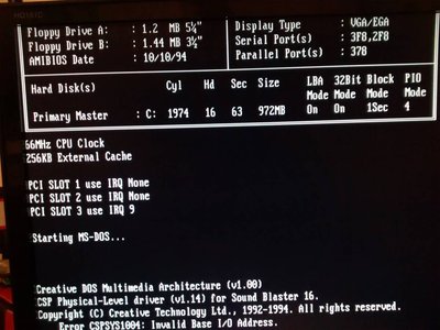

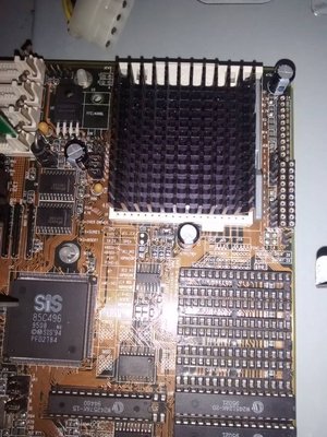

Here i took a picture of my configuration which is 256kb, 4x 64kb chips.
I got 2 sets of chips (i originally wanted to upgrade the board to 512kb), both sets get me the same result - that is no L2 cache is recognized.

    speedsys only sees L1 cache

    closeup

    POST screen says 256kb installed

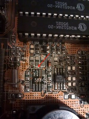

on the pic from the mainboard you can see a free smd space where it reads "555". There is a smd resistor soldered between pins 1-2 that really looks odd. iam really not sure if this is some kind of manufacturing mistake or not...

here is a close up of the odd smd part.
looking forward to hear your opinions
Reply 11 of 20, by Tetrium
I don't know for sure, but I wouldn't exclude the possibility that this was a factory fix. SMD has the same color as the ones near it and repairs of this sort were more common in those days.
My retro rigs (old topic)
Report spammers here!
Reply 12 of 20, by PCBONEZ
LM555 is a timer and it looks like the SMD is across what would be pins 3 and 4 which would be Output and Reset.
http://www.ti.com/lit/ds/symlink/lm555.pdf
Pic of a Ver 1.1 showing LM555 populated. http://www.elhvb.com/mobokive/archive/Microst … MSI_MS-4144.jpg
Pic of a Ver 1.5 with no LM555 and no SMD. http://www.amoretro.de/wp-content/uploads/msi … motherboard.jpg
Reply 14 of 20, by kanecvr
From the pic you posted it seems like the cache chips are set to bank 2? From what I can tell, the cache sockets are numbered V9, V11, V13, V15 and V19, V24, V28 etc. I see you have the cache chips plugged into the sockets with higher values. Try moving the cache chips in the other sockets, or try using 8 cache chips if you have them.
Reply 15 of 20, by Tetrium
I checked this yesterday and according to the manual the cache chips are seated in bank 1 (but I do agree with you it is odd practice to have the lower bank indicated with higher numbers, but strange things happen more often so it might still be the correct one). But as there seem to be problems remaining (and as sometimes manuals simply lie, especially the ones from those dark ages) he might as well give it a try in the other bank provided it won't hurt any of the components.

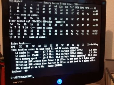

Thanks for your tips, problem is solved.
I reduced the RAM to 8MB - nothing.
I put the cache chips to bank 2 - nothing.

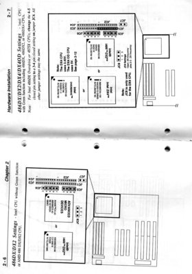

Then i thought i should read the f*ing manual page by page and check EVERY damn jumper on the board.
So i came across the CPU jumper settings page (see below) and the mainboard was jumpered as in the photo

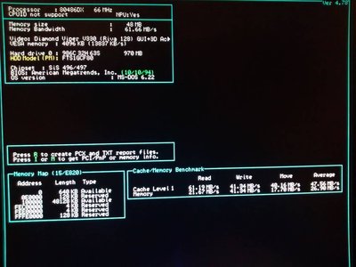

so i put in the 3 more jumpers to JC5 and JC6 and now it works (see screenshot of cachechk).
JC8 is for the 1x or 2x CPU frequency (DX or DX2) see right page in the manual below. This at least was set correctly 😁
Thanks for all the help. Should have read every page of the damn manual earlier 🙁
i bought the machine with 256kb cache installed and with the CPU installed. I didnt change anything cpu related. So the mainboard+cpu did never run on full speed as it does now.
Next thing im gonna do is go for 512kb cache and maybe 40mhz FSB 😀
THANKS again!!
