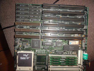

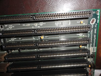

Hello Guys,
Please help me identify this MB, as far as I can see it is some OPTI-895 Deep Green,
but when I try to search on the internet version 4404 ver 1.0 I can't find any informations ;/
Thank you in advance as always 😎

Reply 1 of 7, by brostenen
Uhhhhh... Yikes.... The battery!!!
Reply 2 of 7, by Tetrium
This.
Remove the battery ASAP and clean it up. Use vinegar and some paper cloth or so. If you leave it like this and it still works, the battery stuff will kill the board eventually.

Reply 3 of 7, by Robin4
Maybe a Dataexpert EXP4044 ?
http://stason.org/TULARC/pc/motherboards/D/DA … 86-EXP4044.html
Also
Data Expert EXP4044 and PC Partner VX
