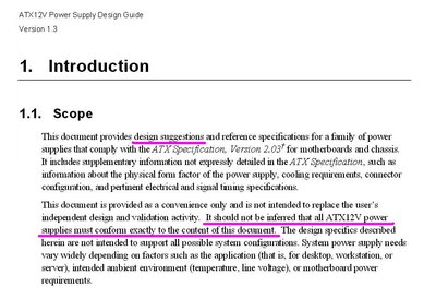

Well according to the design guidelines (page 22) it's called short circuit protection. Over-current protection is more for exceeding the limitations of the power supply, without necessarily causing a short circuit. And in my personal experience with AT supplies, a short circuit in a motherboard component won't blow the fuse. It might shut down eventually once the PSU gets hot enough, but whatever is causing the short seems to heat up and burn/blow before the PSU gets hot enough for anything like that.
So it should definitely be there in ATX supplies (depending on how closely they follow the specs) but AT supplies is a bit of an unknown. I suspect it was easy to implement in ATX since they already have a soft-off control circuit, but since that's not present in an AT supply it would mean more expense adding some kind of shutdown circuit, so it wouldn't surprise me if most AT supplies don't have any sort of short circuit protection (perhaps instead relying on presumably slower overcurrent protection.)

Regardless fuses are short circuit protection and what you asked is when it was first used in PC PSUs.
That's what I told you.
You did not specify "Output" short circuit protection which is apparently what you meant.
If you actually read through that section in your link it is intended to protect the PSU from damage, not the motherboard.
Same purpose as the fuse, and not what you (and others including some review writers) are thinking it's for.
It also states the maximum short circuit energy as 240 VA - on any rail. If it gets that high the motherboard is likely already shot.
(To restate. If there is a short on the mobo the mobo is already toast. Their objective is to keep that fault from damaging the PSU too.)
One of the earlier Design Guides (ver 0.9) actually says modifying a PS/2 PSU and calling it an ATX is just fine, so evidently PS/2 PSUs have this Output Short Circuit Protection you are asking about.
I haven't looked at these side-by-side in eons but as I recall PS/2, XT and AT are indistinguishable electrically so it would follow that versions that existed at the introduction of ATX all would have it.
Because of their age, to get a solid 'for sure' answer about AT you will probably have to resort to interpreting schematics.
I'm a little too busy now to get that involved with it. I come here when I'm 'on break' lately.
I can offer some tips/hints/clarifications.
That it's included in some ATX PSU Design Guide does NOT mean it's excluded in AT designs nor does it mean it's included in marketed ATX PSUs.
Unlike a 'Standard' or 'Specification', compliance with 'Design Guides' is optional. - It says so right in your link in the very first section under "Scope".
That's why they are called "Guides".
87.52 KiB
1015 views
So just because you have an ATX PSU there is no guarantee it will behave any differently than you experienced with that AT PSU.
Manufacturers are not obligated to follow guides so there may be no "Output Short Circuit Protection" at all or it may not work.
That has been demonstrated time and again in PSU reviews.
Also note the v1.3 PSU Design Guide you chose states it is to support the Ver 2.03 ATX Motherboard Specification.
To my knowledge that Specification was never published or made official.
There is no hint of it online at all so if it existed Intel never shared it with anyone outside of Intel.
Apparently they skipped publishing Motherboard Specifications from 2.01 to 2.10 and it gets confused as a PSU Spec which it isn't.
The Specification is what manufacturers are obligated to follow to call their part ATX compliant.
I will use the Ver 2.1 ATX Mobo Specification as the ver 1.3 DG you called up says "ATX Motherboard Specification 2.03 (or later)".
That is here. http://www.formfactors.org/developer%5Cspecs%5Catx2_1.pdf
There is no mention of Short Circuit Protection of any kind being -required- by the ATX Specification.
I know that's not how it should be but that's how it is.
Now rambling. (Some more?)
The Design Guides for ATX PSUs are pushed by Intel.
The ATX Specifications are supposedly handled by FormFactors.org but I suspect it's Intel in the drivers seat.
XT, AT and PS/2 were all IBM Standards/Specifications that date back as far as 1983.
Finding detailed info on those is tough because they are so old.
You would probably have to look at schematics to determine if they have the protection you care about and even then you can't be 100% certain because of all the IBM clones going on back then.
If you look here there are actually at least 40 different Form Factors and over a dozen "Authorities" on their Specifications.
https://en.wikipedia.org/wiki/Computer_form_factor
A lot of them get lumped together and are thought of as part of the same Spec but that isn't actually true.
