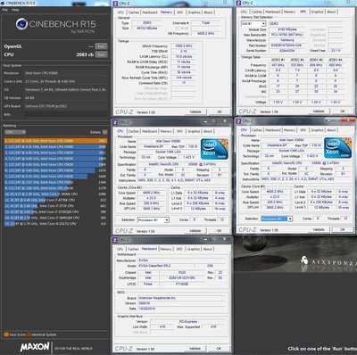

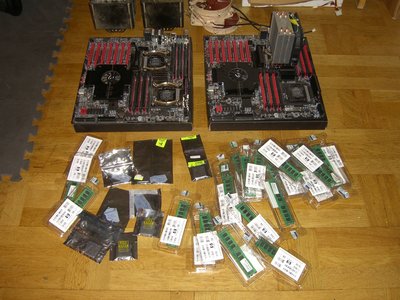

Reply 26 of 52, by Skyscraper
Nice!
Yea the SR-2, the best, most over engineered (consumer) motherboard ever made! I seriously doubt we will ever see a greater achievement when it comes to motherboard design. I even have a complete spare SR-2 system with X5650s @4.4 and another spare SR-2 motherboard safe in its box, I even have two X5650 CPUs for the unused spare aswell. Thats how much I love the SR-2!
The memory overclock is rather good for registered 1333 MHz 8GB modules. 😀

During a rebuild 2 years ago.
