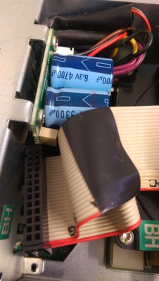

Finally a photo of the ribbon cable to the floppy drive. I presume the HDD is underneath and the power supply behind. Those blue barrels are heavy duty capacitors, I presume? And what's the black grid on the ribbon, an expansion port?
