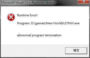

There's a RTS game "Star Trek New Worlds" that have a strange issue on newer graphic cards: It will popup a dialog window like the attachment, saying there's a runtime error.
Last successful run was on a laptop with ATI X1250, Windows7 x64. I think it may have problems with newer drivers that supports directX10 or later. Tried 3danalyze, dgvoodoo2, but without success. It won't run in vmware or virtualbox.
All the dlls referenced in the exe is found in C:\Windows\Syswow64, except mss32.dll which is in the game folder. Tried copied all dlls to game folder, same result.
Has anyone seen other games with similar problem? Is there any solution?
Thanks.

Reply 1 of 19, by yochenhsieh
Never thought I will be able to play it one day...
My specs:
Windows 7 64bit
AMD FX6300
AMD RX470
DDR3 8GB RAM
1.install New Worlds. I recommend to install it in a custom folder like D:\games\
2.copy movies folder from CD to your hard drive root. For example, D:\
3.run regedit, go to [HKEY_LOCAL_MACHINE\SOFTWARE\Wow6432Node\Interplay\StarTrekNewWorlds\1.0.0] and change the CDrom key to the drive where you copied movies folder to.
Download wind3d for windows here:
http://adolfintel.com/?p=wined3d/index.frag
4. extract wined3d.dll, libwine.dll, ddraw.dll to New Worlds folder.
[OPTIONAL]
A hex editor is required. I use xvi32:
http://www.chmaas.handshake.de/delphi/freewar … xvi32/xvi32.htm
5. rename ddraw.dll to ddra2.dll or any 5+3 filename.
6. use the hex editor to open STNW.exe, find ddraw.dll and change it to the new filename you just renamed to.
[OPTIONAL] open game.ini and edit the content:
[STNW]
GAMEXRES=1366
GAMEYRES=768
FedLevel=100
KliLevel=200
RomLevel=300
TauLevel=400
MetLevel=500
HubLevel=600
GAMEXRES and GAMEYRES is your resolution. Yes it supports widescreen without stretch.
The six Level value will unlock all single player campaign missions.
7. right click on STNW.exe, select Properties, and then select the Compatibility tab.
check "disable visual themes" and "disable desktop composition" (on windows 7)
8. Start STNW.exe, press Esc to skip intro video, press space to pause it.
If a widescreen resolution is set in game.ini, be sure not to change anything in in-game options.
Star Trek New Worlds is a RTS game which you can construct ground colony and build little shuttles. But the dev forgot to add a button to savegame.

OK. I edited second post to make the hexedit part optional. It seems many people can get it work without renaming and alter the exe file.
