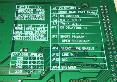

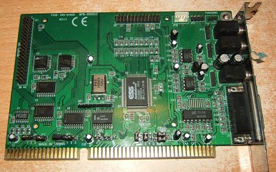

Reply 3 of 30, by BastlerMike
I have an ESS card, where the IDE interface can be configured as primary channel.

Reply 11 of 30, by dr.zeissler
How can I do this. It has only jumpers (and none for the mpu401) and "esscfg" tells me MPU401 is at 300 and disabled.
I can activate it and place it at IRQ2/330. But after a reboot it's disabled again.
How can I enable it, so I can use "softmpu" with joystick/Midi cable.
Is there a TSR or another tool, or a batch file to activate the mpu401?
Reply 13 of 30, by dr.zeissler
esscfg.exe /A:220 /I:7 /D:1 /B:330 /J:E
essvol.exe /V:8 /C:8 /W:8 /M:0
This is what I have found... I will be testing this.
Reply 14 of 30, by Kubik
Also keep on mind that some (actually all I have 😀 ) cheap sound cards don't have IRQ14 connected at all, thus although you could configure them for primary IDE, it still won't work. The card from BastlerMike is OK, but a lot of cheap cards misses most pads on that "small" ISA connector.
