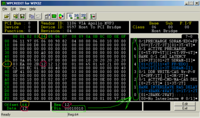

Skalabala wrote:
I can not figure out how to use WPcredit. I have the stuff from K6plus. I know how to load PCR file but how do I save it or make it work?
WPCREDIT can change settings which the motherboards BIOS may not allow.
With WPCREDIT you test the settings for stability, after a restart everything will be back to normal.
WPCRSET will set them at the system start permanently.
WPCREDIT:
Load the right pcr file for your motherboards chipset, it will give you the description for the register settings.
Go on Edit & click on Device. Select your motherboards "Host Bridge" or whatever it is called on your motherboard.
Basically you go thru the registers, read the description on the right site and try a faster setting by changing the binary values which are located in the middle at the bottom.
In the middle at the bottom where it says "Bin: 00010010" the last two digits enable 4-way-bank interleave, if I set the last two digits to "01" it will be 2-way-bank interleave,
see on the right site where it says
BANK INTERLEAVE RAS DELAY
[10=4BANK/4WAY] 0=1T/1=2T
[01=2BANK/2WAY]
[00=No Interleave @ 0/1]*
WPCRSET:
After you have figured out your fast & stable settings, you can add them in WPCRSET to make them permanently.
For example on my VIA mvp3 motherboard: In WPCREDIT on the top left corner it says: PCI Bus: 0 ; Device: 0 ; Function: 0.
on the left at the bottom it says Offset: 64 ; Data: 12.
Add these values in WPCRSET & make sure WPCRSET it is on "Start" on Startup.
With the Register 64, 65 & 66 set at Data 12 I set 4-way-bank interleave for all my ram slots on the motherboard.
I hope someone understood my description. 🤣
