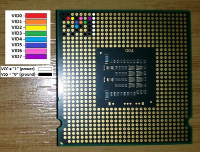

Also, legit PDC VID mod looks like this :
1.56 MiB
4218 views

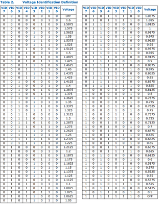

You have to link or isolate contact pads, starting from stock VID, to reach values from VID table.

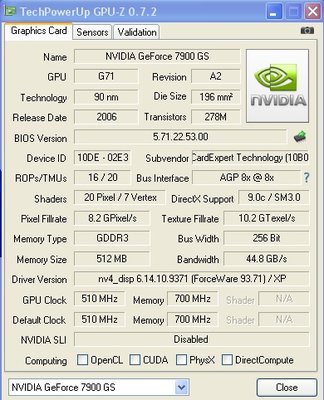

PS. With G70, you could try to unlock pixel/vertex shaders using RivaTuner.
I think in G71 they are hard locked tho...
Here's GPU-z screen of 7900 GS AGP I own :

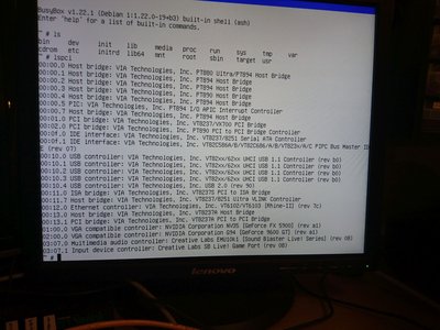

Got a 4CoreDual-SATA2 board the other day, trying to build a dual booting W98/XP machine around it. Want to use a PCIe graphics card in XP, and an AGP one in W98. I don't need both in either OS, just want them to coexist in the machine.
Tried with a GF 9600GT in the PCIe slot, and a GF FX5900 in the AGP slot. The system boots just fine with both cards with PCI or AGP selected as primary graphics adapter in the BIOS setup, but only the FX5900 outputs anything. In Windows, there's no sign of the 9600GT in the device manager. When setting primary graphics adapter to PCIe, the system freezes even before POSTing. Both cards works perfectly in single configuration.
There seems to be some conflicting information on the web whether a dual graphics card setup works or not. Here's a thread where a poster apparently has gotten a reply from the ASRock support stating that it works, but other places, for instance this thread, indicates that it won't.
The mobo is flashed with the hacked 2.20a BIOS from pctreiber.de supporting up to 4GB of RAM. As of now, only 1GB is installed though, to avoid instability/compatibility problems.
My question is simple: has anyone managed to get a dual AGP/PCIe graphics card setup working in any of these boards, or even better, specifically in the 4CoreDual-SATA2, and in that case how?
Edit: Some progress. Booted to the rescue environment in the Debian installer, and lspci at least shows both cards:

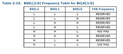

Reply 210 of 705, by agent_x007
Did you updated BIOS to beta one that has 4GB RAM and Wolfdale support ?
I used it for my QX9770 testing.
PS. There is no point in BSEL moding QX9770.
It doesn't support anything less than 1333MHz on BSEL pins (officially) :
17.65 KiB
3513 views
Source : LINK
Reply 211 of 705, by zeratulbla
Yes, it was updated to the last bios, I thought I had achieved 1066 through vid / bsel, I understand my mistake, thank you.

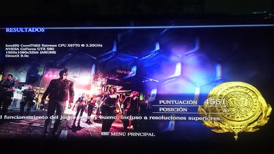

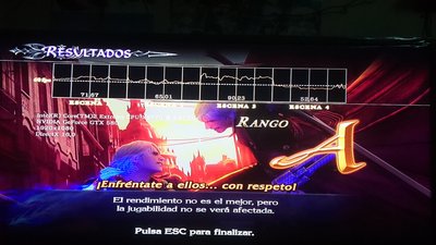

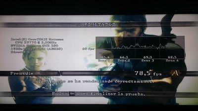

@agent_x007
256 dont boot.
250 boot but very issues.
245 boot but hard disk dont load.
240 boot with hard disk but win 8 restarts automatically and win 7 freeze in boot.
236 boot all normal but with drivers restarts randomize.
232 boot all normal with drivers normalized
i proceed test with resident evil 5 gold edition benchmark.
232 benchmark unstable.
230 - 216 benchmark unstable, stuttering constant.
215 benchmark stable.
i proceed test with re6 and dmc4se benchmark.
215 is stable with 3 benchmarks.
@cxm717
Try not to use official drivers in old nvidia cards in XP, keep the windows drivers, I recommend using systems 7, 8, 8.1 up, for older cards because the system drivers are better.
the graphic performance on old cards improves a little with windows 7 8 and 8.1 drivers.
