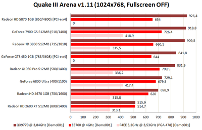

Reply 522 of 705, by agent_x007
sirotkaslo wrote on 2022-01-06, 14:19:
I have a weird issue with my setup. Looks like the hd 3850 is cpu limited, I get about 520fps in q3 at any resolution from 800*600 to 1200*1024.
I have the 4coredual-sata2 with beta bios, E7500, 2*2gb ddr2 ram, hd 3850 with the 13.3 drivers. If i'm going to replace the cpu, which one is better the E5800 or the QX6700?
I would try a bit older driver first (as Quake III is very old game, and newer drivers can perform poorly in it). Try for example: 9.1/9.4 or 10.2/12.4 drivers.
E7500 probably doesn't have enough clock speed to get higher FPS in this game.
It's faster than E5800 at stock clock in some tests because it has larger L2 cache.
Which will help a good bit when memory performace is sub-par (like on this board), and especially on higher CPU clocks (minimum FPS).
Regardless, always make sure CPU is working at full clock when you are testing - C1E/SpeedStep can get finicky and sometimes not work properly.
As for maximum performance you can expect :

^All LGA 775 CPUs were VID moded to request from MB +0,1V more than stock Vcore (that's why these OC clocks were possible), and yes - I used 4CoreDual-SATA2 R2.0 as MB for above test.
PS. Personally, I would use combination of 3DMarks and SuperPI/HyperPI as stability tests on this particular MBs (program : 01SE + 03 + 06 + SuperPI/HyperPI), with actual games You will be playing on it as ultimate stability test.
I say this because Linpack/LinX/IBT (Intel Burnin Test) are VERY hard on VRMs, and this style of boards (like previously mentioned), aren't stellar on VRM quality.
If you don't have enough airflow over MOSFETs they can be easily blown up by too high temps (regardless of CPU temperature).
You can also think about Vdroop+LLC this board has, as sort of permament solution to underpowered VRM shortcomings (force lower voltage on highest powered CPUs under load, to make it draw less power, making VRM's job easier at the same time).
