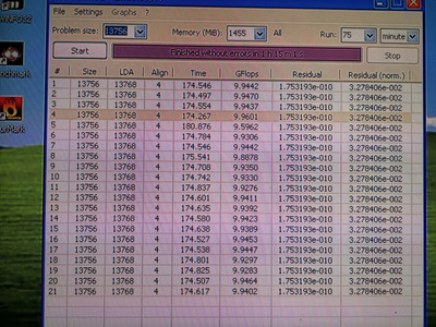

Sounds good to me then as I won't be overclocking. Does anyone here have the combo of this board and this cpu?
Btw - ran the test for 75 mins and all clear

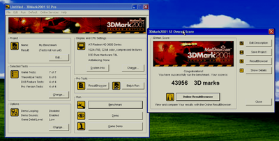

Reply 581 of 701, by RETROKOMODO
I have taken the plunge and updated the bios! All looking good so far after resetting and going back into XP. 3.25gb DDR2 showing and i'll get around to fitting my E7600 over the weekend.

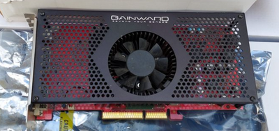

I have an Nvidia Gainward Bliss 7800GS+ Golden Sample/Special Edition/GoesLikeHell AGP card on route to pit against my AGP HD 3850..

Reply 582 of 701, by The Serpent Rider
Interesting, I though they did not use cheap aluminium coolers for 7800GS+ cards.
Reply 583 of 701, by RETROKOMODO
The Serpent Rider wrote on 2022-09-09, 19:58:
I'll interrogate it when it arrives. And hopefully works.. in theory this might be the third gen 7800gs which uses a 7900 chip on a bridge. If internet pages I've found can be believed that is. Should arrive possibly Tuesday ish
Reply 584 of 701, by The Serpent Rider
Judging by amount of marketing bullshit on the box, that card was released after 8xxx series, so that's G71. Probably in 20/7 configuration.
Reply 585 of 701, by RETROKOMODO
The Serpent Rider wrote on 2022-09-10, 12:28:
That's my thought too. Either https://www.techpowerup.com/gpu-specs/geforce … pipes-agp.c3731 or https://www.techpowerup.com/gpu-specs/geforce … 4pipes-agp.c166
I'll know more once I run GPU-Z. Any other utilities to suggest for interrogation?
Either way it should be a good Nvidia card for pitting against the 3850

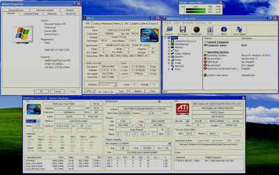

Reply 586 of 701, by RETROKOMODO
Success!!
After much wringing of hands after trying this with my last ASROCK board, I did the bios update and have now successfully installed the E7600 CPU!
1.01 MiB
2041 views
547.33 KiB
2040 views
Thanks to all suggestions and help!

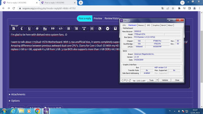

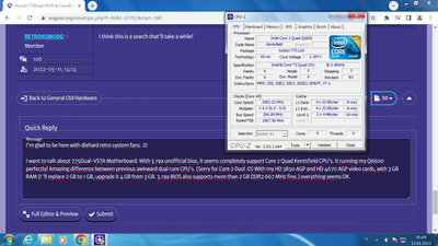

I'm glad to be here with diehard retro system fans. 😁
I want to talk about 775Dual-VSTA Motherboard. With 3.19a unofficial bios, it seems completely support 1066 MHz FSB Core 2 Quad Kentsfield CPU's. It running my Q6600 perfectly! Amazing difference between previous awkward dual core CPU's. (Sorry for Core 2 Duo! 😁) With my HD 3850 AGP and HD 4670 AGP video cards, with 3 GB RAM (I 'll replace 2 GB to 1 GB, upgrade it 4 GB from 3 GB. 3.19a BIOS also supports more than 2 GB DDR2 667 MHz fine.) everything seems OK.
I'll try below and post my experience afterwards.
Core 2 Quad Q6600 (Revision G0, mine is B3 revision and works perfectly!) (Most curious test for me!)
Core 2 Quad Q8400 (Yorkfield 45nm 4-Core CPU) (Probably it will not work but I want to give it a shot.)
5 GB, 6 GB and 8 GB DDR2-667 MHz Memory (Probably it will not work but I want to give it a shot.)

Legacysystem wrote on 2023-01-12, 02:13:
I'm glad to be here with diehard retro system fans. :D […]
Test ended. Results:
Core 2 Quad Q6600 Revision G0: Worked perfectly as its B3 revision twin. After that, I tried Q6700 (It has only revision G0) and Q6700 is worked perfectly.
Core 2 Quad Q8400: Not working in 775DUAL-VSTA. It's not BIOS issue. This motherboard not supporting 1333 FSB CPU's. Its FSB support is only limited at 1066.
5 GB, 6 GB and 8 GB memories: Motherboard and BIOS detected all of them, however I couldn't use them. I'm seeing only in system properties and CPU-Z but ONLY 3 GB of them usable. Also 4 GB ram is not necessary. I tried hard but not manage to pass 3071 MB physical memory limitation. Its probably about chipset, not software issue. Thus, I returned 2+1=3 GB DDR2 667 MHz dual memory sticks. 3 GB is tolerable but I really wanted to pass that limitation but I have nothing to do about it. Continue that great motherboard with that!
