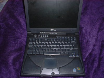

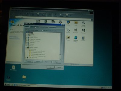

Hi ..
I have a Dell Inspiron 2500 ..
I recently got this going ..and although the sticker says
'designed for XP ' ..I thought this would make a good 98se machine.
So ..nice and easy to install 98se which I've done on account it does have a working floppy.
But I am having problems with drivers..
for example No audio ..No network..No USB etc .
Basically ..no chipset drivers..
I did find a suitable screen/display driver ..so I now have truecolour ..and a larger screen resolution.
I suspect since this was never intended for an O/S less than XP ..drivers may not have been created..?
Could anyone prove me wrong and help here ?

Reply 48 of 66, by LHN91
Vipersan wrote:
Hi .. I have a Dell Inspiron 2500 .. I recently got this going ..and although the sticker says 'designed for XP ' ..I thought t […]
Hi ..
rgds
VS
Looks like the 2500 is a P3-M based machine. It'll definitely work with 98se.
You should be able to get the chipset drivers from here: https://www.philscomputerlab.com/intel.html - you have an intel 815 chipset.
Also, it looks like Dell still has some 9x drivers for the machine. The sound drivers only seem to appear under Windows ME, but they should work on 98se

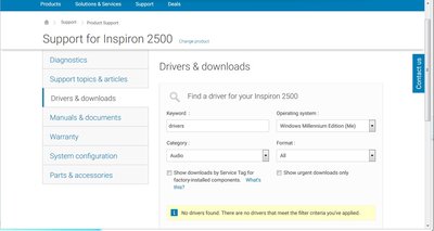

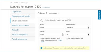

Reply 50 of 66, by Vipersan
So ..I dont know what I'm doing wrong here ..
Sadly the chipset drivers dont help ..
I am still missing LAN and Audio etc..
No audio drivers for any O/S to be found at Dell ..???
please can someone help ?
rgds
VS
hmm ..looks to be wording specific ..
Search for drivers ...finds nothing
search for driver ..me audio driver found.
now that's picky..
    119.9 KiB
    451 views
    110.69 KiB
    451 views

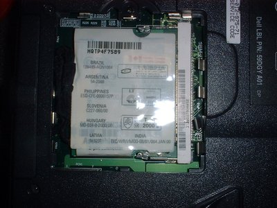

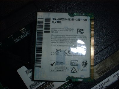

Reply 51 of 66, by Vipersan
Good news ..I now have some audio.
As to the LAN ..
I am not surprised the chipset drivers didn't install one.
There isn't one ?
Yes there is a LAN port and a Modem port on the side of the laptop ..but these are connected to a 3com mini pci dual function card..
which is fitted ..but I assume I'd need seperate drivers for this.
No idea where to go for this ..as it is I suppose not strictly speaking Dells problem
I'm attaching a couple of pics ..just in case someone recognises it.
rgds
    335.52 KiB
    444 views
    348.15 KiB
    444 views
Reply 52 of 66, by Anaxagoras
Vipersan wrote:
So ..I dont know what I'm doing wrong here .. Sadly the chipset drivers dont help .. I am still missing LAN and Audio etc.. No a […]
rgds
VS
now that's picky..
Hi.
I tried the same search and I obtained several results.
Make your selection in the combo boxes first and then don't type anything in the keyword box.

Found this file here :- http://www.dell.com/support/home/uk/en/ukbsdt … driverId=R22739
and took a chance ..
It is for mini pci lan/modem cards ..
No install so unpacked ..did a refresh of the driver and pointed at the win98 folder and it installed the drivers I needed.
I'm feeling quite smug atm..
got access to the internet ..but not much to see in http ..but I can now access my home network..

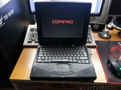

Reply 59 of 66, by Radical Vision
Hi ..
rgds
VS
Well depend, mine Compaq Armada is made for Windows 95NT but i did install XP, and it run well, as the previous os Win 98 was corrupted..
I don`t see how if Win XP runs fine, there will be better at 98...
Only solution i can find is to have one laptop for XP, one for 98......
