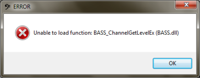

Reply 22 of 36, by Laukku
I tried to install this via the "VST MIDI Driver (as a system MIDI synth)" method, but whenever I try to connect to the driver (for example, in DOSBox I set mididevice=win32 and the appropriate midiconfig value) I get the attached error message and the application crashes. All other MIDI devices work fine, including Munt.

Reply 23 of 36, by Falcosoft
This error has nothing to do with S-YXG50 since it does not use BASS.dll at all. But e.g. Coolsoft VMS and Bassmidi driver do use BASS.dll so most likely you have failed to configure the correct midi out port or the VST midi driver itself to use syxg50.dll.
Edit:
It seems VstMidi driver also uses Bass.dll so it might be a BASS.dll version conflict between VST midi driver and Coolsoft VMS/Bassmidi driver. Try to remove Coolsoft VMS/Bassmidi driver and reinstall VST Midi driver.
Edit2:
If you do not succeed in using VST Midi driver you can still use DosBox and S-YXG50 with a virtual midi cable and a VST host (like FSMP or SAVIHost)

Reply 25 of 36, by kode54
Yes, that is a BASS import bug, because it appears your VSTi MIDI Driver is somehow importing the wrong version of BASS.dll, even though it explicitly is supposed to be searching its own folder for it.
Both of my MIDI drivers use BASS's DirectSound output on older systems, and BASSWASAPI on Vista and up. The sample rate bug only manifests with WASAPI output, since the DirectSound output always chooses 44100Hz. The WASAPI bug will be fixed soon.

Reply 34 of 36, by VEG
kode54, two persons complained me that the new version of the VST MIDI Driver has some unknown problem with some of players, for example, vanBasco. They say that it just doesn't work and tells that some unknown internal error happened. Trying to play a midi using KaraFun v.1.20.86 shows this error: Unable load function Bass_ChannelGetLevelsEx (Bass.dll).

Reply 35 of 36, by Falcosoft
Hi Veg,
This must be the same problem as Laukku reported earlier: Yamaha S-YXG50 Portable VSTi (a software MIDI synth)
And Kode54 has already written:
The problem is both VMS 1.x and vstmididrv are inprocess drivers that implicitly using bass.dll (and bassmidi.dll). So in spite of Kode54's trying to load bass/bassmidi.dll explicitly from its own folder it does not work if VMS 1.x has already imported the same dlls implicitly into the player's process. (You can see e.g. in Sysinternal's process explorer that because of inprocess behavior bass/bassmidi.dll is in the given player's (e.g. Van Basco's) address space. So if VMS 1.x has already loaded a different version of basss.dll into the process's address space vstmididrv cannot load its own version anymore.
The solution can be:
1. Uninstall VMS 1.x. Optionally try the 2.x branch since AFAIK it uses out of process driver behavior so the player's process does not use implicitly bass/bassmidi.dll anymore.
2. Try to replace bass.dll/bassmidi.dll in VMS working directory with the newer one that vstmididrv uses. It should work, there are no breaking changes in 2.4.x versions of Bass.
But in case of my own player FSMP I have experienced that in spite of no dll version conflict I still get sometimes 'error 5 cannot play bass channel' with my own bassmidi implementation after using either VMS 1.x or vstmididrv. So solution 1 is more secure.
3. Using LoppMidi + FSMP can also be a solution since FSMP is a VST and Soundfont host and midi router in one without conflicts.

Reply 36 of 36, by Falcosoft
I have checked KaraFun 2.5.1 and the problem is this player itself also uses the Bass libraries. It is the same problem as with VMS 1.x. If the player loads its own bass version then vstmididrv has no chance to import its own (even newer version).
Edit: I have also checked version 1.2 of KaraFun. The situation is the same. Also solution 2 from the above post does not work since the application checks that old version 2.4.6 of bass.dll can be found in its own folder and insists to use only this version. So there seems to be a fundamental/architectural problem with midi applications and in-process midi drivers that try to use the Bass libraries simultaneously. Maybe that's why VMS 2.x dropped the in-process driver idea.
