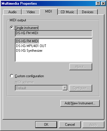

Reply 21 of 230, by Stretch
Tertz, do you know of a translated GUI for YMF7x4Utilities ?
I was able to use the program to enable FM MIDI output on my YMF-744 under Windows 98SE, so now I can play MIDI with FM or the XG Synth.
I am curious what else I can do with this program.
