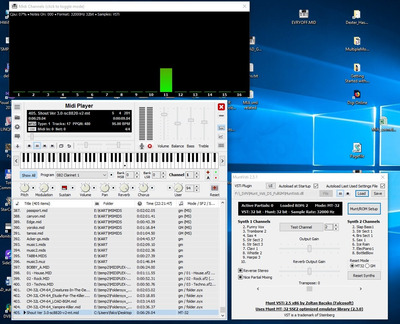

No, there is no difference between the old and new version in this respect. Actually there is no such thing that you could do in the old versions but you can not in the new version.
With your attached Midi file the 2nd synth remains silent even in the old versions, because you included an unnecessary MT-32 reset.
Here is a screenshot using the previous version 2.5. As you can see from the 'Active Partials' data both synths are silent when the file sends data to channel 11. It's because you included an unnecessary MT-32 reset. Remove it or replace it with a GM OFF and both versions (old/new) plays it with MT-32 instruments on all channels
244.32 KiB
1743 views
Here is one that works perfectly with 16 channels MT-32 instruments with both new and old versions:

This is not true 😀 . Both versions need the same resets for same configurations. Show me a video about the difference on your side.
Make sure 'Dual Synth' option is enabled in new version. With this option enabled the new version behaves exactly like old versions. The only difference is that in the new version there is an option to not enable dual synth mode.
