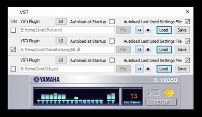

Reply 1409 of 1699, by dank0
Hello Falcosoft.
i am using your player with dosbox and i am using it with vst plugs Roland/munt/yamaha. but i dont like all the time look for my plug directory, it will be nice to have small bookmark area in the VST window - check the image
138.79 KiB
1182 views
AMD K6-II 500, Nvidia TNT2 AGP, 256 MB RAM
•• WANTED: ROLAND SCP-55 ••
Reply 1410 of 1699, by Falcosoft
dank0 wrote on 2023-03-15, 22:24:
Hello Falcosoft.
i am using your player with dosbox and i am using it with vst plugs Roland/munt/yamaha. but i dont like all the time look for my plug directory...
Hi,
You do not have to. That's why Main Menu -> Configuration Presets exists. You can switch between configuration presets many ways but maybe the fastest is Ctrl + Alt + Preset number.
More info:
Re: Falcosoft Soundfont Midi Player
BTW, do not forget to check the 'Autoload at Startup' checkbox before saving a preset. And you should also fine tune other settings before saving presets like sample rate, custom patch definition, SysEx reset type etc. since for different synths different options are ideal.
Website, Facebook, Youtube
VST Midi Driver Midi Mapper
