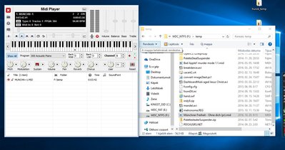

K.A.R.R. wrote:
hello just tested latest fsmp
it cannot playback midi files with ü ö or ä in the file name
Hi,
The 32bit version has no unicode support since it supports even Win9x (ANSI only). Typically ANSI programs can only use filenames that use characters the operating system's current codepage (system locale) supports. So you should set your operating system locale (user locale is not enough) to German from default English-US . But in 32bit midiplayer I have implemented a workaround that solves the problem of unicode characters in file names by converting the file names to old 8.3 format (DOS) short file names.
This picture shows 32bit Midiplayer playing files with üűő etc. in filename that my codepage/system locale (Hungarian) supports and another file 'GUITAR~4.MID' that has the original filename 'бныGuitar!_обороны.mid' with cyril characters my codepage does not support.
230.55 KiB
2553 views
This is working on my PC but it requires short file name generation to be enabled on the filesystem. If it is on your system I do not know what can cause this problem.
(If you can make a screenshot how the files look like in the playlist maybe I can identify what your problem is).
BTW the 64bit version of midiplayer has full unicode support so if you have many similar files with unicode characters in the file name you should download and use the 64 bit version.

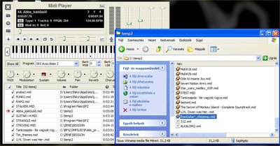

Reply 177 of 1727, by Falcosoft
Hi,
I'm glad the 64 bit version is working for you, but I think something is not perfect with your system. On all of my systems (including Win10) this file can be opened by 32bit midiplayer (by the mentioned built-in 8.3 short file name trick, so no rename is necessary).
228.64 KiB
2539 views
Please try this command in an admin elevated cmd window :
fsutil 8dot3name query
This should be executed on your D: volume. What kind of volume is this ? Normal NTFS on a normal HDD/SSD ?
@James-F: Can you confirm this behavior? Thanks in advance.
