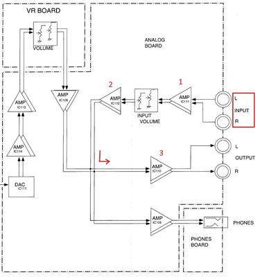

Are you sure?
The CM-64 schematic shows the exact same VCA configuration as the MT-32 v2.

Reply 428 of 1702, by Cloudschatze
James-F wrote:
Are you sure?
I don't have the CM-64 service notes in front of me, but from recollection, the output from the CM-32L board is sent to the CM-32P board and mixed prior to the analog volume knob phase. This isn't at all the same as the v2.0x MT-32 configuration, as neither the CM-64, nor CM-32L, provide a similar mechanism for VCA control through their volume knob.

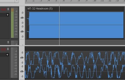

Reply 432 of 1702, by James-F
@HunterZ
Thank you again.
All the Round 2 recordings at 100% synth volume are completely distorted at the input of your sound card !! 😵

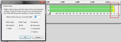

I don't understand HunterZ, don't you look at the input meters? The 100% synth volume recordings should peak at -3db, adjust line-in level accordingly.

The lower synth volume recordings are perfectly fine, and as Cloudschatze said there is indeed some attenuation before the DAC on the CM-64, so it is hybrid between Digital and VCAs.
But the default in MUNT is 100% and it returns to it after a SysEx reset, so un-distorted hardware recordings with 100% synth volume are more important here.

1. The recording chain should be as pure as possible: MT-32-> Line-In
NOTHING should be between the MT32 and the recording Line-In, because every analog input and output has its own input and output amplifiers... you are basically adding more amplifiers that may clip.
2. Up till now you are clipping the recording input of your sound card again and again. 😐
PLEASE lower the line-in of your recording sound card;; 100% synth volume should peak at -6db in Audacity, please lower your line-in levels.
I repeat, NOTHING should reach 0.0db digital full scale when recording.
Make sure that the Input Meter in Audacity does NOT reach the Red area when the CM-64 is at 100% volume.
Adjust your line-in levels till the input meter is around the -6db, with the CM-64 playing the headroom.mid at 100% synth volume.
The blue line indicated the peaks, so the blue line should not reach 0.0db EVER in the digital domain.
Don't be shy of low volume in the digital domain, low volume equals to headroom, you can always boost or normalize it later but clipped data is lost forever.
112.75 KiB
1339 views

So yes, lower the line-in to compensate for hot signal levels, this is how it is done.
my suspicion is that the line-in signal will go through the ADC at full volume, and *then* get scaled in the digital domain by the sound driver according to the line-in level setting.
Exactly.
As I mentioned, the analog path before the ADC should have plenty of headroom for anything audio related.
This would actually produce an even worse result than my previous recordings because you'd just be throwing away dynamic range without eliminating clipping.
Ah, this is where you're wrong, and probably the reason you refrained from lowering the line-in level.
On the contrary, hotter signal (voltage) at the input with lower input gain will result in more signal to noise ratio, that's why pro audio uses higher line voltages.
Maybe I should have kept things going through the SC-88 after all
Absolutely NOT.
The SC-88 input->output path adds 3 more op-amp to the signal chain, one of them (IC111) is before the SC-88 input trim so it will definitely distort with hot input signal.
The JVC probably adds even more amplifiers and multiplexers, that's why it is important to keep the signal chain minimal, MT-32 -> Line-in.
But as you say the JVC is a pro gear, so it should have plenty of rail voltage at the op-amps.
