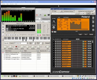

Hello, good job for this player, the most complete I've ever seen (ignore Sysex in files, force manual control and more !)
It's works perfectly with latest Wine in Solus :
S-YXG50 VST works but no SC-VA VSTi, no idea if it's Wine or not.
Reply 591 of 1699, by Falcosoft
I would not say it's perfect, it desperately needs a font pack with an Arial like font 😀
It can be a Wine + SC-VA authorization component problem. The situation is similar in WinXP. You can use SC-VA but only WITHOUT installation. You should install SC-VA in an other OS, and under Wine use only the folder where the already installed SC-VA instance can be found. And in FSMP browse to the folder and select SOUND Canvas VA.dll. I have tried it and it works but in the worst case you have to wait a couple of minutes while SC-VA initializes (It initializes in 2 steps: first you should wait while a dialog appears saying 'SC-VA works in trial mode' and then you should wait for the UI to appear). It works in a never ending trial period, but the 10 minute session limit is active.
Also make sure you use the bitness correct version of SOUND Canvas VA.dll. There are both 32 and 64 bit dlls installed on x64 Windows into c:\Program Files (x86)\Roland and c:\Program Files\Roland correspondingly. With the x86 version of FSMP you can only use the 32 bit version of SC-VA and vice versa.

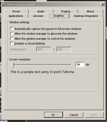

Also I recommend disabling advanced windowing options in Winecfg:
49.88 KiB
2376 views

Reply 592 of 1699, by Bakuredo
Indeed, it's looks awful without Arial font but it's works 😉
It's a Wine + SC-VA authorization component problem. The situation is similar in WinXP. You can use SC-VA but only WITHOUT installation. You should install SC-VA in an other OS, and under Wine use only the folder where the already installed SC-VA instance can be found. And in FSMP browse to the folder and select SOUND Canvas VA.dll. I have tried it and it works but in the worst case you have to wait a couple of minutes while SC-VA initializes (It initializes in 2 steps: first you should wait while a dialog appears saying 'SC-VA works in trial mode' and then you should wait for the UI to appear). It works in a never ending trial period, but the 10 minute session limit is active. .
Thank you for help ! My SC-VA works now !

Reply 594 of 1699, by Bakuredo
OK, I'm glad. One more little useful tip for SC-VA. Since without working authorization component it only works for 10 minutes in one session, when it stops and displays the session over dialog you should press Stop and right within 5 seconds Play again in the plugins dialog. Since FSMP does not unload stopped VST(i) plugin dlls for 5 seconds, SC-VA initialization in this case is much faster than the full/initial one and the timer resets itself also without full unloading 😀.
Oh my version of SC-VA seems have a working activation :
