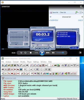

Reply 624 of 1730, by Falcosoft
Hi,
I think I have found the best compromise. I have added an additional Auto(All -> MS GM) option to Compatibility -> Channels options. This will be the default one. It switches between All (channels 1-16) and MS GM Compatible (channels 1-15) automatically depending on detection of the MS meta sequencer event. This way users who do not care/understand this whole problem still gets proper sound. And even in case of a false positive detection only channel 16 is sacrificed (unlike in WMP where channels 11-16 are skipped). I have not found so far midi files that include this special MS meta sequencer event and contain non-drum notes on channel 16.
Although this solution is different from WMP's but so far resulted in better sound and compatibility. And if you want you still can select a different channel layout manually.

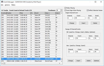

I've noticed that my Roland SD-50 produce MIDI in a different way if before playback i send a SyX containing GS Standard mode.Could it be possible to implement an analysis of the midi file to verify if it contain only GS Mode or it's a full compliant GM Mode?
in FSMP it's actually very easy to tell what midi system (SysEx message) a midi files uses, there's no need for implementing additional 'analysis'.
1. On the main display you can see what kind of reset SysEx message the loaded midi uses/sends last (it's the first row that starts with an icon and says either GM, GM2, GS, SC-88, XG, MT32 or NX)
2. You can also open the Even Viewer/Debugger dialog where you can inspect the SysEx messages included in the file.

Reply 628 of 1730, by Falcosoft
I'm trying to understand: for example i've loaded a specific mt-32 midi file with syx for mt-32 hardware but the icon mark this midi file as GM.
I should see this as MT-32? I refer to the tracks from dune 2, monkey island 1 and monkey island 2 specific for mt-32 and i always see GM.
No. You mix up 2 different things. In your original question you referred to 'Midi files'.
So in my answer I considered only midi files.
If you send an MT-32 or any other reset SysEx messages to your synth, that does not influence/modify the reset messages included in the midi file.
So on the interface you still see black 'GM' if the file itself contains a GM reset message. I think it's logical. An example: If you send e.g. a GS reset to a synth that supports it the synth switches into GS mode. But if you start playing a file that contains an explixit GM reset message it will override your previous GS reset message. So the file will be played in GM mode. If you want to avoid this you can prevent the file to send its own reset message by disabling Main menu->SysEx Options->Enable SysEx in Files.
By the way a 'grey GM sign' means no explicit SysEx reset message is detected in the file (so it's handled as a GM file since GM is the most common denominator system and most GM midis do not include explicit GM reset messages).
But a 'black GM sign' means that the midi file contains an explicit GM reset SysEx message.
Edit:
To sum it up:
If the file contains GS mode reset then you will see a black 'GS' sign when you load it. If it's a full compliant GM (meaning it contains an explicit GM reset) then you will see a black 'GM' sign.
If the file contains neither you will see a grey GM sign meaning midi system is not defined in the file.
In these cases you can see a grey GM sign since these files do not contain any explicit SysEx messages since the SysEx messages (including the reset) are in a separate syx file.

HI,
today when i was recording trough Roland SD-50 Daggerfall Sondtrack i've noticed that a mid file retirieved a wrong time.
I'll embed this here.

Hi,
2:46:34 is the correct length of this midi file. Other players/midi software agree with FSMP:

Unfortunately this midi is badly programmed. Someone had left a legitimate controller event on Track 6 at 2:46:34. FSMP has already a workaround against badly placed End of Track events, but it already caused problems for users who wanted End of Track to behave according to standards. So there is already a compatibility option to enable/disable 'Ignore End of Track for Song Length'. But I think ignoring normal controller events is more than a player should/can do to compensate problems caused by badly programmed midis.
BTW It's very easy to correct the problem. You only have to delete the problematic event on Track 6 an save the file:

@Edit:
Here's the corrected file:
