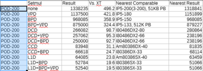

Reply 20 of 44, by clueless1
Tertz wrote:
Would be more comfortable to see one table with all settings-results from the fastest to the slowest for Ezra-T 1000. As you also have Nehemiah 1200, its results are similarly interesting.
Agreed. Something maybe like this:
78.76 KiB
2799 views
Doom Results
18.43 KiB
2800 views
Speedtst Results

j^aws wrote:
This is the slowest I can achieve in Speedsys - 9.46pts, using the slowest timings in the BIOS.
200MHz; L1D; BPD; Slowest BIOS timings
and ICD slowdown option seems as not available with this
By disabling L1 cache, ICD (Instruction Cache) should be disabled too, and make it redundant.

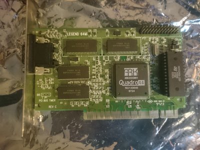

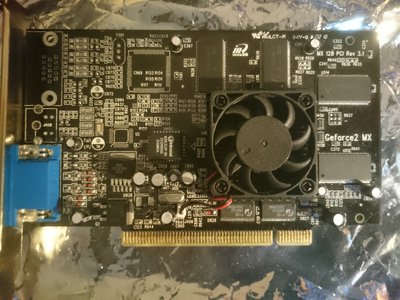

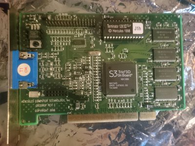

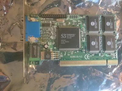

I managed to get some random benches with a few PCI cards today:
2.96 MiB
2735 views
Voodoo 3000
2.49 MiB
2735 views
Nvidia MX200
2.62 MiB
2735 views
S3 Trio3D 365
2.41 MiB
2735 views
ARK 2000MI+ Quadro 64
3.02 MiB
2735 views
S3 VirgeGX
Results below >>

Ezra-T was clocked at 8x150 - 1200MHz:
149.98 KiB
2735 views
Surprisingly, the MX200 did very well and was the fastest. And the ARK Quadro64, looking the least capable, kept up with the pace. Still undecided on what to choose...

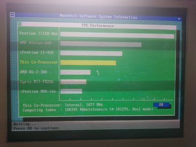

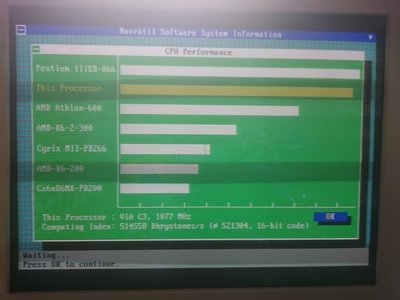

This is what NSSI shows for the Ezra-T, 150x8, 1200MHz:
3.19 MiB
2613 views
2.83 MiB
2613 views
You can see Dhrystone and Whetstone comparisions with other processors. BTW, it can't detect the correct MHz speed for the Ezra-T. The FP is close to a PII 450, and Integer close to a PIII 800...

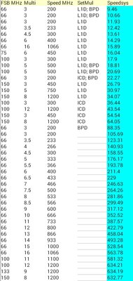

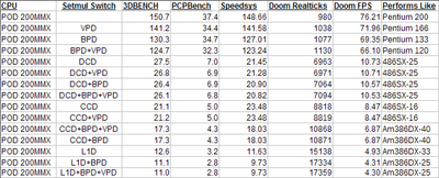

And as requested, I've tabulated my earlier Speedsys results:
127.57 KiB
2613 views

I've tested a few more cards, and from running old demoscene stuff, it looks like an Nvidia M64 trumps the above for compatibility... Probably going to choose that card.
Reply 32 of 44, by Tertz
Real mode, - probably it's for 16-bit operations. Performance in Win9x apps may differ.
Nice. Similar table for Nehemiah 1200 is also interesting for comparision.
Nvidia cards are good in this, and are one of the fastest (PCI and AGP) in DOS up to Geforce 3. In SVGA games this may to be important, besides benchmarks.

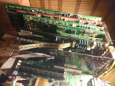

Okay, so I haven't forgotten about this - just been really busy lately.
After testing the board and CPU, I wasn't sure on what I wanted this build to focus on. Eventually, I decided to stuff it full of soundcards that are mainly geared towards non-wavetable synthesis. Below, a sneak preview on the current status:
3.19 MiB
2478 views
I managed to get six soundcards playing nice with each other. Various incarnations of Yamaha OPL: YMF289, YMF262 and dual-YMF3812. Alongside them, supported by a MOS SID 6581(Innovation Replica) and Philips dual-SA1099 (Game Blaster).
Wavetable synthesis is supplied by the GF1 on the GUS MAX, and the EMU8000 on the AWE32. The rest will come from external synths using Roland MPU-401 and SoftMPU for Intelligent Mode.
For graphics, I've been back and forth. Currently installed is a Voodoo 5500, but I had a GeForce MX400 until recently.
Installed from top to bottom :
CT3980
GUS MAX 2.1
CT1330
CT1300
SSI-2001
YMF-724F
V5500
That's it for now. I'll be testing a bunch of batch files for all this to work smoothly. Any thoughts will be much appreciated...

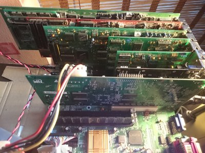

So, getting six soundcards installed was tricky, and I nearly forgot how I did it. I'll be documenting some rules that helped me:
- For the AWE32 CT3980, install it correctly. Which means get to know CTCU, CTCM and AWEUTIL. Ensure to also install the Device Driver CTCM in CONFIG.SYS. You can disable various parts of this card using CTCU. Importantly, you still need to initialise the card using CTCM, even when parts are disabled. Otherwise, ports are hogged from other cards.
- For the GUS MAX, this card can easily live with others due to its non-conflicting ports. However, it needs to be initialised, otherewise it may block FM on other cards for some games.
- For the Sound Blaster Pro 1, removing jumper from port 220 disables the card, so that others can work alongside it and use its DMAs and IRQs.
- For the Game Blaster, if all other cards are disabled, it can live on port 220, which is the most compatible. It also needs no DMA, nor IRQs; minimising conflicts.
- For the SSI-2001 Innovation Replica, it is the simplest to configure. It needs an uncommon port of 280, and no IRQs, nor DMAs.
- For the YMF724 using SB-Link, forcing a PCI IRQ in BIOS helps conflicts. I force low IRQs of 3 and 4 to this card and the Voodoo 5500. The Sound Blaster Pro 2 ports, IRQs and DMAs can be set differently using SETUPDS.
I have a very simple AUTOEXEC.BAT with all relevant PATHs, and within it, I call upto six batch files configured for each sound card. In these individual batch files, I have all relevant environmental variables, such as SET SOUND, SET BLASTER etc... Once all tested, I'll probably setup a menu-driven startup.
The PnP resource manager in the BIOS needs to be tweaked carefully. I like all the Sound Blaster cards to use the popular port 220, and this is achieved by initialising/ activating the relevant card. I keep both the PnP AWE32 and YMF724 on IRQ 5, and the SB Pro 1 on IRQ7.
Finally, I use the default DMA1 on all these SB cards, so the only change in the BIOS I need when changing cards is setting DMA1 to Manual/ Auto. I force DMA0 to Manual, so nothing uses it, and the AWE32 grabs the first available DMA of 1. It does the same for the first available IRQ of 5.
The BIOS settings for the GUS are left Manual for IRQ11 and DMA7. It uses port 260.
Once setup, flicking through these six soundcards is fairly trivial. I'll setup an external toggle switch to enable / disable the SBPro1 with a simple case-mounted switch. Haven't looked into a suitable external mixer yet; undecided on this...
Phew, that seemed a lot, but in practice, it's easy to switch sound cards...
EDIT:
Reminder that HIGHSCAN option for EMM386 in CONFIG.SYS causes issues with AWE32 locking, so avoid this entry.

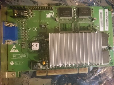

Reply 36 of 44, by j^aws
A small sidenote after further testing: The YMF724 needs the GUS not initialised - the reverse of when using the ISA cards for FM.
I can't resist filling all slots, and the last slot has always been the most difficult - currently has the V5500. Realising the focus of this build and future complementary builds, I wondered if I could get seven soundcards installed. So I dragged out my neglected TerraTec EWS64XL, mainly to checkout its 4236b CrystalFM, and managed to make it the seventh working soundcard!
2.9 MiB
2415 views
I just used the basic PnP Crystal CWDINIT and CWDMIX DOS tools, forcing the 'o' switch when initialising. This can't get the two MPUs working. Anyone have a working set of DOS files, preconfigured to work with an EWS64XL 1.2? I have the installation CDs buried in some random box, and finding them is going to take a while. Thanks in advance.

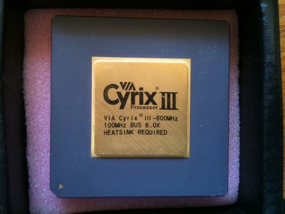

VIA C3 Samuel 2 and Erza/Erza-T is known to have the FPU running at 1/2 of the CPU clock, if your C3 runs at 1200 MHz, the FPU runs only at 600 MHz
VIA C3 Nehemiah has the FPU running at fullspeed, so this is why Nehemiah is considerably faster, but also Nehemiah has a deeper pipeline (16 stage vs 12 in Erza/Samuel 2) and many other changes like cmov instruction support and the replacement of 3DNow! with Intel's SSE
I wonder about the VIA C3 Samuel 1 (known as VIA Cyrix III) which is even slower than Samuel 2, but extremenly rare.
VIA Samuel 1 uses a older process (180 nm), higher voltages (1.8-2.0 volts) and doesn't have L2 cache at all. Ranged from 433 MHz up to 733 MHz
Reply 38 of 44, by j^aws
^^ I think I might have a Samuel 1 somewhere. Do those have Cyrix silkscreened prominently over VIA?
For slowing down, the Nehemiah is lacking a speed range around 486DX-33 to a P133. It behaves more like a PIII when using slowdown techniques.
Reply 39 of 44, by BSA Starfire
I have one of these, I ran Phil's VGA Benchmark suite and entered the results here:https://docs.google.com/spreadsheets/d/1lvF9n … wpNU/edit#gid=0 It's entry 437 of the now locked database. This was on a very fast ASUS CUSL2 (intel 815) motherboard with a 3DFX Voodoo Banshee so I suspect you'll not make it go any quicker than this for DOS games. It is a very slow processor indeed. As you can see it's sharing positions with 300MHz and under CPU's on the benchmarks, Cyrix MII's @ 250MHz are faster overall.
Here is a photo of my chip.
1.04 MiB
2280 views
