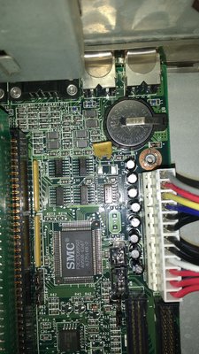

More progress, or rather the lack of progress.
I did a complete recap of the motherboard, as well as the caps on the riser-card.
Everything is working as they were, before I replaced the caps.
So I guess that the recapping in its self, were a success.
The bad news, is that the issue were not related to the caps.
Oh well.... The board got some fresh cap's. 🤣
The board will still not post with the coincell BIOS battery in place.
Only when the battery is removed, and some time passes, the board will post.
It is as if something does not discharge or something like that, and prevents
something from doing a POST on the board.
I think the issue is in one one the components in this picture.
Does someone recognice this issue? And guide me on to what to measure with
my multimeter...

Reply 30 of 40, by BloodyCactus
maybe start doing some continuity tests on the power rails and ground rails.

Reply 32 of 40, by brostenen
That yellow component! Is that a capacitor? And could that be the culprit?
It is linked to the diode somehow and the diode is linked to the battery holder.
Reply 33 of 40, by BloodyCactus
I think that looks like a self resetting PTC fuse
--/\-[ Stu : Bloody Cactus :: http://kråketær.com :: http://mega-tokyo.com ]-/\--
Reply 34 of 40, by brostenen
True.... Googled it. If it is broken, what impact could it have?
Reply 35 of 40, by BloodyCactus
its a fuse, if its broken, nothing shall pass!
PTC fuse by design 're-close' after being blown. they reset themselves. does not mean it could not be broken.
if you have a multimeter you can put it on continuity and touch each side of it with both leads and if it beeps, its not broken.
Reply 36 of 40, by brostenen
Think it is broken. Nothing flows. It does not even have any resistans.
Reply 37 of 40, by brostenen
Checkes it again today. True enough, no voltage is flowing through that little sucker. That being with the computer turned on. what I can't get my head around, is if this has some impact on the battery issue. I might be wrong on it all together. I simply can not find any info online. As far as I can read the component, it is a 30volt 1.35amp right?
