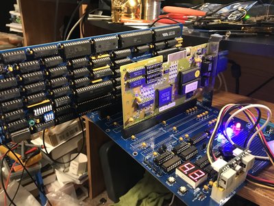

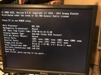

Reply 553 of 613, by Berzerkula
Wahooo! Received a different VGA card. This one is an XP6676P with a WD90C11A-LR. I've ordered some 256KBx4 70ns DRAM for upgrading to 512KB. The TVGA8900D VGA output was dead. I may troubleshoot that later and have a few different VGA cards on the way to test with this unit.
I don't have precision equipment to measure the OSC at pin 12 of U1, and my primitive oscilloscope with DSVIEW shows it at 14.32MHz. Can't see anymore significant digits. It's probably okay. I've attached some pictures of the video output, backplane, Xi8088 board and the XP6676P with 256KB cache.
My next adventure is the floppy controller and solder some more ISA edge connectors to the backplane. I should have that done very soon.

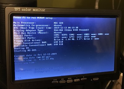

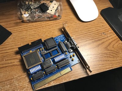

Reply 555 of 613, by Berzerkula
Have the Floppy/Serial controller built. No need for the ROM at the moment.
I have MS-DOS 6.22 booting from some brand new disks and created a startup disk with some good ole Dysan media.
If anyone looks closely they'll see a mistake. Easily fixed with some tender care.

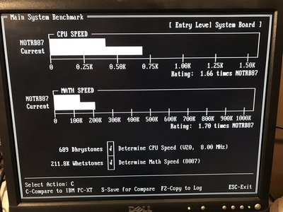

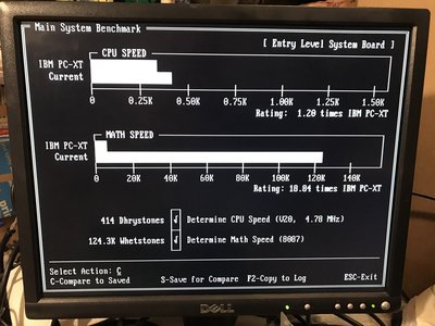

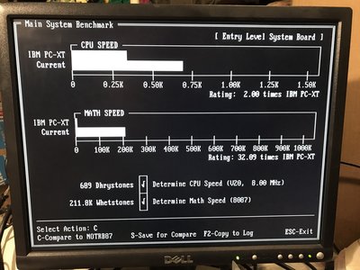

Reply 559 of 613, by Berzerkula
Greetings everyone!
After a bit of remembering how the MFM cables worked and the WD1002A-WX1, I also realized, someone had put a WX2 bios in the WX1 controller. So I erased it with the UV lamp and burned the Bios Super Formatter v 2.4 F300 and setup the Miniscribe 3425 drives and all went well. With these twisted MFM cables, the middle connector ends up being drive 0 and the end connector drive 1, so that tripped me up for a bit, but I got it sorted. I'm sharing some screenshots. Some with turbo on, too. I have an 8087-1 with the Xi8088 now.
I did low level format the first drive with an interleave of 6 without turbo. I've formatted the others with 5 and with turbo enabled. I've noticed a significant increase in performance with turbo and the interleave of 5. Not sure if I can go to 4 or 3 with this.
