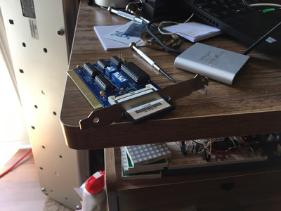

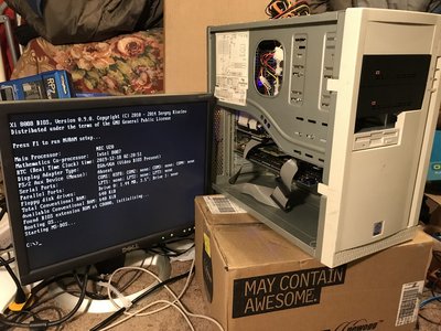

I finally formatted 4/4 MFM Miniscribe 3425 drives, but one had an issue. I do have 3 working. I now have two of them in the case. My next issue is a case that has the micro atx mounts so that I can use all 8 slots, but that'll be hard to find. Going to have to mod this case. But it is working out nice, so far. It's been about a month and have gone far with this project.
Next up is the OPL2 kit and XT-CF-Lite. Wish the XT-IDE Rev 4 wasn't so sparse, I'd like that. May have to get the board manufactured and order parts seperately. Don't see kits, and the assembled kits are not I want. I built this sucker from scratch, I'm gonna do the rest that way. With cat claws, and badgers, and ....
I've used this case for so many things, now it's gone back to an XT build, haha. Very versatile.

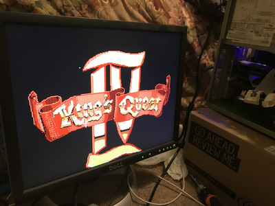

The XT IDE CF Lite works like a charm. Most important task I had to do after removing the non dos partitions was execute “FDISK /MBR” after creating the primary and making sure it was active. Loaded a bunch of programs to it and King’s Quest was in all of its glory, haha. I plan to assemble the OPL2 and Micro 8088 later. Right now, I’m figuring out an enclosure for this beast.

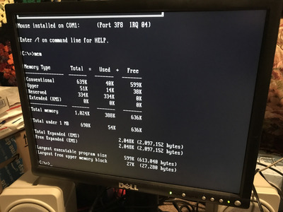

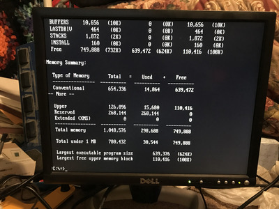

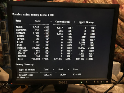

One topic I’ve scoured Vogons, retrowbrew, vcfed and everywhere else, is how UMB is to work. I remember having a Laser 386 and it had 1mb ram soldered to the board. I mowed lawns to buy such small memory modules to upgrade ram. It was a 386, but there is an option to turn reserved memory space to ram for an 8088. What I haven’t seen clear,is if it is through the bios, because it reports findings, or through a driver. Switches SW2.1 to SW2.7 are all on for me so all addresses are mapped to ram. My current vga adapter has its address starting at A000000. Just can’t seem to use the extra address space the SRAM provides.
You feel a whole lot more like you do now than you did when you used to.
Reply 562 of 613, by root42
All VGA are at A000h. So there is no chance to move that. I have no experience with UMBs on XTs. Only on ATs. But did you try to simply do a DOS=UMB in your config.sys and try to DEVICEHIGH and LH some drivers and programs?
YouTube and Bonus
Reply 563 of 613, by BloodyCactus
umb will present itself as ram in the c000 to efff space. you can use a driver to map it.
Reply 564 of 613, by root42
This driver should work:
https://github.com/monotech/NuXT/blob/master/ … OS/USE!UMBS.ZIP
YouTube and Bonus
Reply 565 of 613, by Berzerkula

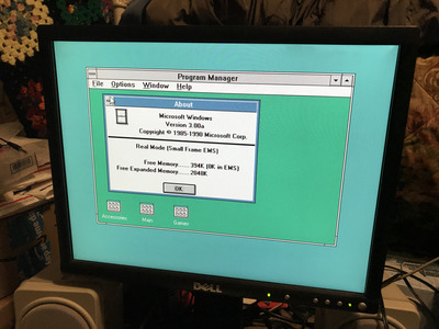

Thank you Bloodycactus and Root42. I found the tool I needed! Utilizing v2.2 of USE!UMBS from http://www.vcfed.org/forum/showthread. ... a-XT/page3 and DOSMAX21, I was able to use C800-F000 and use upper memory.
Reply 566 of 613, by root42
Congratulations! Now you can even run Windows 3.0 on it with some useful amount of RAM! 😀

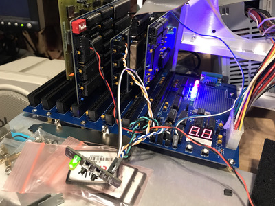

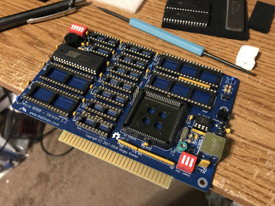

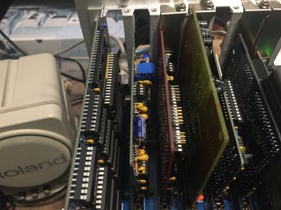

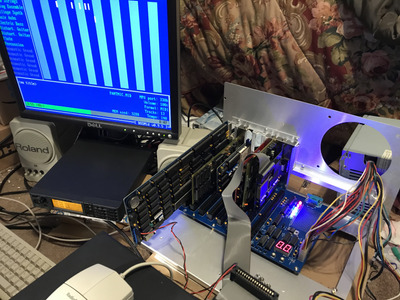

Not only that! After adding the HardMPU from ab0jt, it's rockin' like a hurricane. It's been a joy playing midi data through it to the Roland SC-55 for the last 5 or so hours with no hiccups. It soothes the brain while assembling the Micro 8088 board. Current setup pictures are attached. I went the way of Scott Baker's Mountain Mod's tray. Drilling some 7/64 holes and tapped some holes for the mounting studs helped secure it and enable the use of 7 slots. It is a bit more stable rather than in a Micro-ATX case where only 4 slots could be utilized because of the layout.
8088 Domination's Badapple and Triton's Crystal Dreams demos run.
Upon further inspection, my initial population of the peripheral IC's for the Xi 8088 didn't include the all of the modern IC's ordered. I'm going to repopulate them one at a time as there are some 5MHz only IC's populated. After that, I'll install the Micro 8088. It isn't fully populated, but I'll show a picture of that anyways.
Sincerely,
William

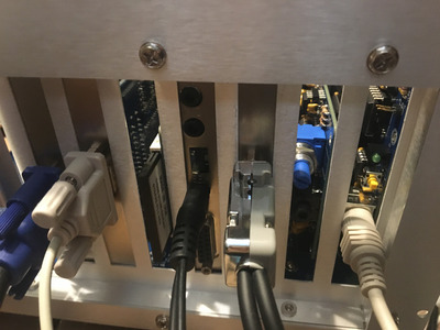

Up next is to take some time and start measuring and drilling holes for the keystone brackets. I did find one issue with the OPL-2. The POT knob doesn't really fit in the middle of the keystone, It's kinda all the way to the top when the card is straight vertical and not one side to the other. Seems like the hole for that keystone is gonna not work too well. I used the same POT in the BOM 91A1A-B24-D15L
Perhaps the board is a bit off alignment with the standoffs, but most of the other boards are vertical and fit well.

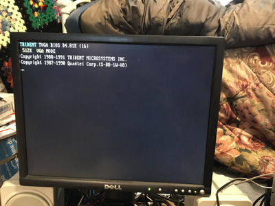

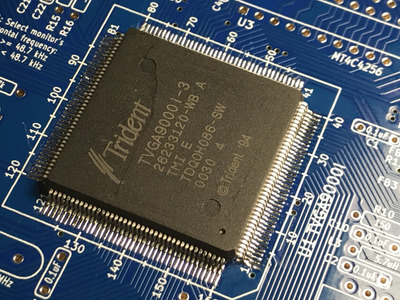

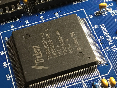

ISA Super VGA on the way. Took about 10 rounds inspecting with a jewler's loop. It is looking great. Had a couple snags, but my MacGyver buff ability gave me some help. Hoping to have the Super VGA going today. Hand soldering is a bit tedious when there are hiccups. The most useful tools were some SMD rework tools and a soldering wick. Don't use so much solder, keep it light and use flux. It'll help a lot.

Wahooo! I’ve completed the Xi 8088 build. Have windows 3.0, too. Up next is Scott Baker’s ISA additions. The vga card didn’t work at first. The BIOS always hung at 11. I reflowed all the pins and then it worked. Wahooooooo!

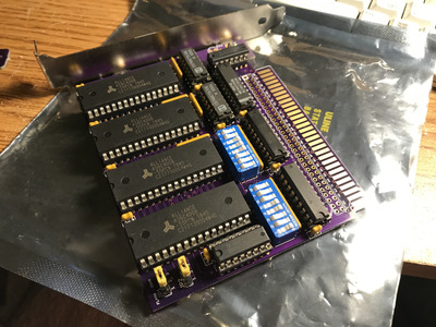

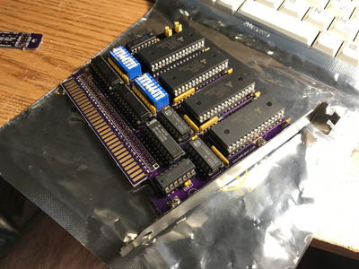

I did get some backup FE2010A IC's for the heck of it. So far, the whole build is stable. I got SMBaker's Flash/EMS board completed, and have 2MB EMS whenever needed. It won't be often.
For the whole build, some parts are real tedious, so I just listened to music or caught up on some shows to listen to while I did that. That was mainly during the Micro ATX backplane and Xi8088 pcb. Lots of solder joints there. I'm still hesitant to reel out the drill press and Dremel and work on the keystones for the Xi8088, Micro 8088, OPL2 and CF cards. I guess I'll just hunker down one day with the calipers and get it going.
The rest wasn't too bad. I thought that was torture, this is my next project:
Single Board Relay Computer "Trainer" Haha. I'm a glutton for punishment. By the way, if anyone builds Scott Baker's Flash/EMS board, you'll need to manually crawl through the original LTEMM (from Lo Tech EMS driver source) and his changes cause the patch won't apply cleanly. I created a decent diff to use, and have the executable if interested. If enough interest, I could post it.
I've cloned Scott Baker's and added the executable and updated diff from the latest LTEMM source. https://git.berzerkula.org/sbems/about/
The DIP switches are set for Page Frame E000 and base port address 260h. Be careful how you orientate the DIP switches. If upside down, will match Scott's. If proper, will be opposite. Haha.
