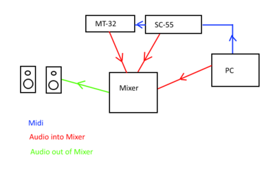

Hey folks, how are you? I mostly lurk here, but now I'm coming to y'all for some advice. I recently acquired a Roland MT-32 to use it with games that support it, and I love it! I'm kinda hooked, so I want to expand my hardware and add a module that support General Midi as well. After doing a lot of research, I'm mostly keen on a Roland SC-55 Mk2 Sound Canvas.
That said, I only have one PC with one soundcard. Currently I'm using a USB Midi interface with the MT-32, which is also connected to the line-in on the sound card. I'm therefore wondering if it's possible to be able to connect both an MT-32 and SC-55 to the same sound card so I can choose which to use whenever.
I'd appreciate any advice on how to do this, and I thank you for your time. 😀

Reply 1 of 32, by BloodyCactus
you can use the THRU/THROUGH port to go from the mt32 to the 55 but you do need a stereo selector or a mixer to select the desired output.
remember the mt32 has 1/4trs out jacks, the 55 has rca jacks, so you will need to do some conversion. you can probably use old AV selector box and ignore the svideo and just use it for audio selection

Reply 8 of 32, by jesolo
Here's a little guide a copied from an internet site at one point.
Reply 9 of 32, by James-F
If you care about sound quality and noise level you must not forget that chaining analog audio through several devices adds to the noise level.
Each device in the chain has an op-amp (amplifier) at the input and the output, the PC sound card will convert the sound yet again with input and output amplifier and two digital-to-analog/analog-to-digital conversions.
MT32 (output) -> SC-55 (input) -> SC55 (output) -> PC (input) -> PC (ADC) -> PC (DAC) -> PC (output).
The amount of amplifiers in each stage will elevate the noise floor even if nothing is playing, noise is also an audio signal.
Unbalanced cables pick up interference noise, and chaining different audio devices may create ground loop problems and a "buzz" on the audio signal.
I suggest a small mixer (Behringer 1002 for example), this will parallel the op-amp chain instead of chaining it in series.
Your speakers should be connected to the mixer outputs, all the devices (PC, MT32, SC55) should connect to the mixer inputs and mixed to your liking (make sure you don't clip).
Also you do not want to attenuate the signal and then amplify it again, this is the worst thing you can do to deteriorate signal-to-noise ratio (SNR).
So turn your PC output to full, MT-32 volume to full (but not clipping) and SC-55 to full (but not clipping) and attenuate at the mixer.
Cheers.

Reply 17 of 32, by Veloxi
Ah, this is perfect, so connecting the USB Midi interface I already have to the SC-55, I use this:
https://www.amazon.com/gp/product/B000068NTK/ … d=ATVPDKIKX0DER
To connect the midi thru ports on both devices, then this:
https://www.amazon.com/Hosa-CPR-202-Stereo-In … ch+to+rca+cable
To connect the output from the MT-32 to the input on the SC-55, then this:
https://www.amazon.com/gp/product/B000068O3A/ … d=ATVPDKIKX0DER
To connect the output on the SC-55 to the line-in on my Sound Blaster sound card.
Does that sound right? I don't mind turning both units on if that's what's needed.
If it has a spaceship in it, I will play it.
Reply 18 of 32, by Veloxi
James-F wrote:
If you care about sound quality and noise level you must not forget that chaining analog audio through several devices adds to t […]
Cheers.
So wait, I'd have them go each to a separate mixer, which would then go to the PC sound card?
Reply 19 of 32, by James-F
13.36 KiB
2939 views
Midi Chain (2 cables):
PC midi output -> SC-55 Midi Input,
SC-55 Midi Thru -> MT-32 Midi Input.
The mixer blends and adjusts all the audio inputs, and outputs a combined (mixed) signal to your main speakers.
No need to go back to your sound card.
