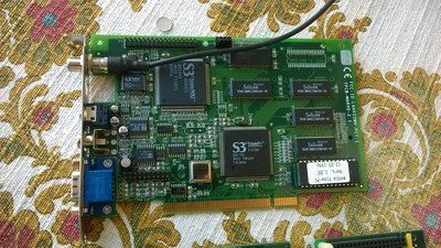

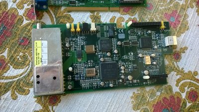

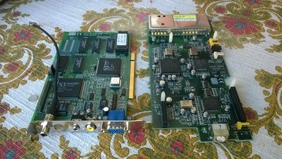

I've obtained an old Miro PICO 100 VGA and TV combo card:
The attachment WP_20160616_006.jpg is no longer available
The attachment WP_20160616_005.jpg is no longer available
The attachment WP_20160616_004.jpg is no longer available
Can it be used in any way? Is the onboard video card any good and what can one do with all the S-Video outs and stuff? Plus it seems that this card also has an audio processor.
Can any one tell me what are this cards capabilities? Thanks.

Reply 1 of 22, by Sammy
I have the Miro-Media-View with Mpeg-Decoder and TV-Upgrade.
Seems the Upgrade is the same.
You can use it to watch analog TV.
FBAS and S-Video are inputs.
Only the 3,5mm is an Output for the Audio.
You can also connect an Sat-receiver or an VCR to it.
Maybe some game consoles
Videotext / Teletext should also work.
Reply 2 of 22, by Scali
Yes, you can use it as a capture device for PAL/NTSC signals over composite or s-video (bypassing the TV tuner part).
So if you want to make video captures of old consoles, home computers, or CGA/PCjr/Tandy composite computers, you could use such a card.
As a video card, it's not bad, just a standard S3 Trio64V+-based card, which was a reasonable Windows-accelerator at the time, and has good (S)VGA compatibility for DOS as well.
The S3 Scenic/MX2 chip on there is an MPEG decoder chip, so it's probably also great for watching CD-Video/DVD stuff on a low-end PC.
Reply 3 of 22, by Nintendawg
I actually think the TV tuner part is the most useful. Because it could record obscure video game consoles or ancient computers that only output a modulated rf signal.
With recent gear that's impossible without adding a separate VCR or demodulator in the chain.
All the other features can be done better on newer hardware, but I know nostalgia makes us retro guys do crazy things. 😊

Reply 6 of 22, by Sammy
That card can't record video. Only still images can be Captured.
It displays the Video live in a Window or Fullscreen.
Also the Mpeg Decoder chip only decodes Mpeg1. (Video-CD Format, and CD-i).
Was great to watch Fullscreen Video in color with my Pentium75.
My Pentium 200 with Software Decode, only gets around 15 fps in Color or 25 fps in Black/White.
I connected a C64 to the input but the Picture was moving, from down to up (or up to down) because the C64 signal is not Standard.
But other consoles should work (nintendo, sega, anything with RF-output or scart)
