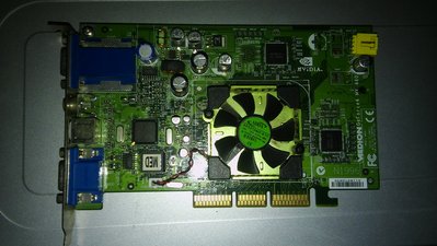

I got recently a Geforce 4 MX 460, also Medion Branded. Manufactured by MSI (MS-8863). I bought it in a ebay auticon for 2 € (5 € shipping)
    2.18 MiB
    2241 views
    The card
Reply 16 of 20, by gravitone
The nice thing about these medion cards is the expansion header on top. These boards were all made my MSI as custom orders. The top connector wires up to the video encoder used for TV-output, and unlike basically all other nvidia cards where the header is present on the pcb but the port never soldered on, it provides full 15khz RGB output. Medion always wired these up with an expansion bracket with a full rgb-scart socket. For anyone in euro land that wants to hook up a graphics card to a CRT tv, this is definitly the way to go. Custom wiring to hook it up to a sony BVM/PVM or other CRT with rgb inputs for anyone in NTSC territories is also a great option. I'm still that no board vendor ever wired it up and provided at least an optional bracket, since its present on almost every nvidia pcb design from geforce 3/4 upto geforce 7 series cards (confirmation of said "fact" to be determined by this community I hope).
