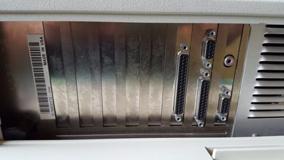

I just got a IBM 5155. My project is to get 8088MPH to run on the machine.
The machine only has two 5 1/4" 360kb disk drives.
I have MS-DOS startup diskett for MS-DOS 3.3
I want to connect it to a newer computer with a Nullmodem/LapLink cable.
Problem: I don't seem to have a serial port on my IBM 5155? - See picture.
Could anybody tell what ports i have?
That is correct, a serial port was not standard back in the day. You need a separate ISA card for that.
I think the large connector is the external floppy connector on your floppy controller card.
The card with two connectors looks like an MDA card, so the 9-pin connector is monochrome video, and the 25-pin connector is a printer port (yes, this also was not standard, if you only had CGA, you didn't have a printer port).
The other card looks like a CGA card with composite and 9-pin RGBI output.
You can use the printer port to communicate with other PCs though. You could use the Fastlynx software for that (and you'd have to build your own cable, or buy one somewhere, since it's not as common as a nulmodem).

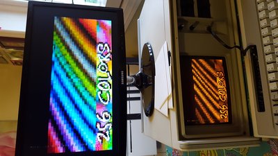

I have now testet 8088MPH on my IBM 5155 with 256 KB RAM
https://www.youtube.com/watch?v=kopMLn0j9EI

Scali wrote:
Great! Sadly you can't run all parts of 8088 MPH with just 256 KB of ram. But the stuff that runs, seems to work perfectly 😀
Thank you for being considerate enough to make it handle low-memory systems gracefully, and still give them part of the experience! 😀

Today i got my ISA card with 384kb RAM. Now i have 640kb. This meant i could see the whole 8088MPH demo, and play more games.
Only mod i am waiting for know is a Compact Flash adapter that first at the back brackets. With this i can access the CF without opening the cabinet.
