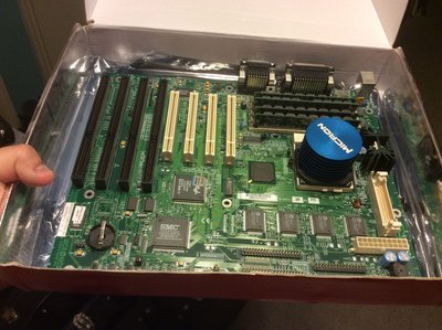

So, other stuff I have lying around in boxes that I'm going through.
Intel Pentium 200 FV80502200 with what looks like a permanently-attached heat-fin tower by Micron. It's a metallic blue, has a central core up the middle and what looks like office floor levels coming off of it as heatsink fins. I looked up the processor and it's only 15.5 watts. No wonder you didn't need active cooling on these things.
It was in a motherboard - a Micronics \- MB M55HI 2MBO9B 09-00273-35 REV B5 - 09-00273-35 I took the battery out just now because it has GOT to be old as crap and dead.
It had 4 ram sticks in it. I'm looking them up as I type this post.
First one has a sticker that says SEC KMM5324104BK-6U. That's a 16MB 72pin 60ns EDO DRAM SIMM. Only one of these.
Next one has only one sticker that says X ram 4x32. Whatever the hell that's supposed to mean. Each of the 8 chips are identical and say:
Korea C006
9725 FFF
HM5117400S6
I looked up that last number and it's apparently a Hitachi Semiconductor 4,194,304 - WORD x 4-bit Dynamic RAM. So 8 of those chips and you get whatever storage it's supposed to be.
The last two are IDENTICAL. HYM532100AM-70 They are 4MB EDO DRAM 72-pin SIMM. So apparently 8MB total between the two sticks.
So....8MB + 16MB + whatever the hell that unmarked one is. So a minimum of 24MB. And I have no idea if they even work worth a damn. But it's cool that I have this stuff.
Some cool stuff laying around. I guess if this MB worked, it would make either a really good Windows 95 system, or a stupid-fast DOS system. It does have 4 PCI slots, but I have no PCI 2D card. The only PCI adapters I have are my Voodoo2 cards, so uh, dunno. But it looks like it has built-in audio. The chip is marked:
VIBRA 16C
(c)Creative Tech '95
CT2505-TDQ2
9642-SS1122C1
What I'm missing from that board is a "Power Module." I have no idea what that is. I'm looking for a manual online for this MB now.
    1.7 MiB
    1165 views

Reply 33 of 105, by shamino
FFXIhealer wrote:
Well, I pulled out my big bag-o-ram that's on my shelf of un-confirmed RAM sticks from way back in the day, contains DDR1 and DD […]
Well, I pulled out my big bag-o-ram that's on my shelf of un-confirmed RAM sticks from way back in the day, contains DDR1 and DDR2 sticks. I found a bunch of DDR1 stuff. Tried them all out on my system and while I found a matching pair of 256MB 133MHz DDR sticks, I also found ONE working 1GB 166MHz DDR stick that works in this system, so Windows XP just got a huge upgrade in RAM. I've updated the CPU-z validation file accordingly:
I think the mis-matched 256MB sticks might have been the cause of XP hanging at random times. Since this is a single stick, I'm going to run a memory test to see how stable it is. I mean, it's not like I'm using the computer for anything else, right?
Considering that it's an ABit board and when it was made, it probably has bad caps. ABit switched to Rubycon eventually but at the time of the KT333 chipset I think they were still using Jackcon, which are junk. Replace them if you can.
Reply 34 of 105, by ODwilly
For a 2d card for the Pentium board, grab an s3 trio. Cheap and easy 😀 I have a later version of that Micron board with a 166mmx and integrated Virge graphics. With an opl4 yamaha chio instead of the Vibra built in. EDIT: just wanted to add that my hdd limit is 40gb on mine and the power pin is in that big row of jumper pin. Carefully jump the pins with a flathead screw driver until you identify which ones are the power
Reply 35 of 105, by FFXIhealer
Yeah, I just looked up that Vibra chip. Apparently, it's a Sound Blaster 16 chip made for OEMs to put on boards like this. It uses an ISA-type bus to run it on. Hey, I'm not complaining. I love Sound Blasters back in the day and Creative Labs, to me, was always the audio king for PCs. Hell, I even bought one of those 24-bit PCI-E Fatality cards for my old i7 build from 2010. Turns out, the audio quality of the included audio riser card was perfectly fine, but I still have that audio card laying in a box.

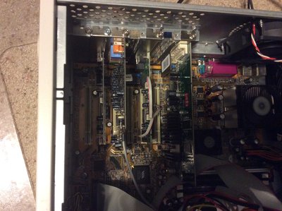

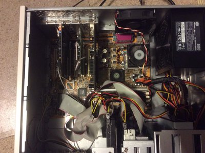

And the computer has been on all day yesterday downloading and installing Windows XP updates. Today, it's just sitting there. Although I'm concerned that there is 18GB used on the hard drive. I don't think I have THAT many games/ROMs installed. I'll have to keep digging.
I just found the missing rails for that case, so I put the floppy drive back in. Now, when I try to run CPU-z, it freezes the computer at 15%, the Processor stage. Mouse won't move or anything. Could be the RAM, could be the caps you were talking about, could be the updates that were installed, could be the floppy connected to the system. Dunno. I tested the floppy drive and it works properly - read the files on the disk and everything.
And I just looked up that S3 Trio on Ebay. Between $18 and $40 for one. And that card would do well running MS-DOS type games? Of course, if I were going to spend money on this, I'd also get the Voodoo1 4MB card and a pass-through cable.

I took two more shots, this time of the Abit MB and the Athlon XP system running Windows XP. The system is running a HDD defrag as I take these pictures. The reason the case is open is because I took out the crappy 80mm rear exhaust fan for a better 92mm fan to push more air out. The system has been on for about the last hour, so inside the case is getting noticeably warm. Hopefully, this helps cool it down a bit more. That Radeon 9550 doesn't have an active fan on the heatsink. I hope that really means it doesn't need one. The system was originally built with a 7500 with only 64MB of memory. I know, because the box it came in is where I found all the stuff for this computer, including the missing drive mounting rails and all the CD-ROMs and documentation for it. 🤣
The 1st picture is the expansion cards I have in. From left to right, it's the USB 2.0 card, the Sound Blaster Live! 5.1 card, the SMC 10/100 Ethernet card (with WOL cable connected), then the ATI Radeon 9550 card.
