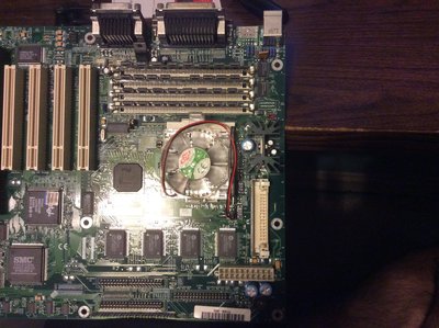

Intel had a specification for removable voltage regulator modules that go into sockets like that. They were most common on higher end Pentium Pro and P2 era boards, and most especially with boards that supported multiple CPUs. The latest board I've seen them on were some Dell GX150 P3 Coppermine boards (but later GX150 boards have it soldered permanently instead). I've never seen them on a socket-7 before your picture.
Those VRMs were identified by a revision, but I don't remember what revision corresponds to what generation of CPUs anymore. I've had a little experience using those things but not enough to be certain of how interchangeable they are.
Since it's a socket-7 Pentium board it might be the earliest generation there is of those removable modules. I'm not sure if there's any danger posed by using a VRM that's too new. One issue that I think does have to be considered is that I've seen those VRMs labeled based on what input voltage they expect (all mine say 5v on them). If the input voltage didn't match I'm sure bad things would happen. Lacking any documentation, you'd have to use a multimeter to figure out what input voltage is going to that socket, or given how close it is to the ATX power connector it might be possible to eyeball it.
It's possible the VRM isn't for the CPU but is instead for the onboard cache memory, but I think that's less likely. Some boards had multiple VRM sockets, one for each CPU and one for powering their cache.
There seems to be an onboard linear voltage regulator sitting near the CPU, plus the removable VRM (currently missing). So it's a little confusing what's doing what here. It uses an ATX power supply so it shouldn't need an onboard 3.3v regulator. I'm guessing the removable VRM is for the CPU power, and the onboard regulator is for something else, but not sure what. The only way to figure out the scheme for sure would be to poke around with a multimeter.
Reply 41 of 105, by squareguy
I don't think the 'power module' is needed at all. There is a voltage regulator soldered on the motherboard right beside it. I found the manual for this board and it describes a jumper setting to switch between two CPU voltage regulator modes. Willing to bet this was intended to support future CPUs / overdrive if ever required.

Reply 42 of 105, by FFXIhealer
Yeah, my research showed the same, SquareGuy. So I just now tried powering up the board now that I got the Matrox G450 PCI card from another member here. And it powered up fine without the Voltage Module. In fact, I just ran a full MemText x86 floppy (that I just made for this purpose) and it passed all 40MB of RAM at 100% with 0 errors. Looking pretty good for a late Windows 95 build to me. Now I have to figure out what I want to do about a case, a budget PSU, and storage. I'd like one of those 1GB CF card thingies, but I'm not going to go out of my way to figure this out, if you know what I mean.

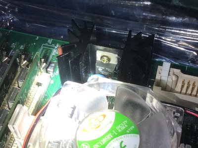

Reply 43 of 105, by FFXIhealer
Clearer shot of the big thing next to the CPU socket. There's a small transistor screwed onto the side. I'll try to get a better picture of that later.

Reply 44 of 105, by synrgy87
Thats a heatsink with a voltage regulator, something like a 7805, will be dropping a higher voltage to a lower one like 12v to 5v or 5v to 3.3v or something to feed the cpu / ram / whatever else.

Reply 45 of 105, by FFXIhealer
Here's the codes on the chip on that small heatsink: CS-5206-1

Reply 46 of 105, by shamino
http://www.datasheetarchive.com/CS5206-1-datasheet.html
That CS5206-1 is an adjustable voltage regulator that can output up to 6A. "Adjustable" meaning that the voltage is set by some external resistors. If there is any voltage adjustment jumper on the board then it's probably changing the resistance value that the CS5206 sees.
Assuming that it's providing 3.3v for the CPU then it can handle about 20W. I wonder if it's an isolated circuit for the CPU or if it's tied in with the whole board's 3.3v rail, which might also get power from the ATX connector.
I was surprised to find I already had a datasheet saved for the CS5207, so I guess that must be what I found in the onboard 3.3v regulator of a Baby-AT super-7 board I was working on a while back. Looks like the CS5206 and CS5207 are the same thing just with different amperage ratings. That super-7 board had AT and ATX power connectors. When using AT the CS5207 was providing the whole 3.3v rail for the board, and when using ATX it was still active, tied in parallel with the ATX 3.3v rail.
Reply 47 of 105, by FFXIhealer
Well, from what I understand, the Pentium 200MHz is being fed directly from that, but if you had the Pentium MMX that came directly after this, it had a lower voltage requirement, so required that power module to be installed (that I don't have). I'd have to go back to look at all the jumpers, but most of them set features or bus speed or clock multiplier. None of them were marked for voltage, to my knowledge.
