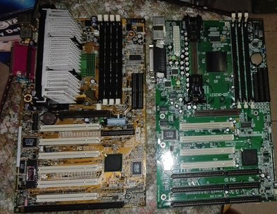

I've read this thread, nice! I'll build a 1998 pc too! As always , sorry for my poor english.
In 1998 i was still using a p200mmx ,matrox mystique 220 paired with a voodoo2.The Voodoo 'magic' was awesome, but a bit overkill. Quake 2 looked great.
All my friends all had pentium 2 equipped with the mystical voodoo banshee (we all had this voodoo banshee craze at the time), i was left behind! In '99 i did build a celeron 400,sold the voodoo2 and bought a tnt2 ultra...
It is time to get back to the past!
656.01 KiB
1014 views
I have a couple of qdi legend BX motherboards,they should be the correct age. Also have the asus p3bf but it's 1999,i'll use it for another project.

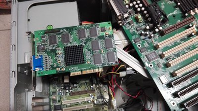

The Voodoo Banshee donated by one of my friends! (thanks again, i'll buy you a beer!) 16 mb agp from 1998
