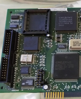

Reply 41 of 1053, by Pierre32
Cool! I have a CT1740. Here's an interesting thing though - our cards have different socketed chips.
166.55 KiB

Reply 42 of 1053, by maxtherabbit
Pierre32 wrote on 2022-09-26, 01:10:
maxtherabbit wrote on 2022-09-25, 19:21:
I had to add the socket for the DSP myself. The chip was soldered directly to the PCB from the factory just like yours
Reply 43 of 1053, by Horun
I have a CT-1770 (nearly identical to 1740 but scsi not ide) with dsp 4.11 and would like to down grade to 4.05. Now maybe I can 😁
My 1770 has a socket for ASP/CSP chip like pierre's (not soldered smd) so a bit less room to work with but do-able I think.
Reply 45 of 1053, by Horun
maxtherabbit wrote on 2022-09-26, 01:19:
It is doable. My CT2230 also has CSP socket and I made it fit. Had to file down the outside of the PLCC-44 socket just a fuzz for clearance
Curious what programmer you used. My TL866 does not list 80c52 but does 87c52. Wondering if P87C52EBAA SIGNETICS would work ok.
Reply 46 of 1053, by maxtherabbit
Horun wrote on 2022-09-26, 03:58:
I used a TL866 as well. 80C52 is a mask ROM - 87C52 (EPROM) should be fine, I used a 89C52 (EEPROM)

Reply 48 of 1053, by maxtherabbit
appiah4 wrote on 2022-09-26, 13:13:
The major issue here is desoldering/soldering the SMD components 🙁
removing the DSP is a cinch with hot air, I hand soldered the socket after cutting away the plastic in the center - wasn't too bad at all

Reply 55 of 1053, by maxtherabbit
Frankly hand soldering the PLCC chip directly to the board is easier IMO, if we were at a point where a truly bug free binary was available I wouldn't have bothered with the sockets
