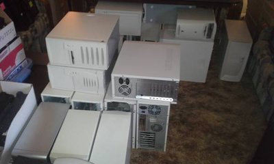

Reply 43 of 64, by Oldskoolmaniac
I did end up with all those case's for $20 most of them all come with power supplies, all case's are brand new, the screws are still package and still have the original packaging plastic around the cases.
Two of the case's are brand new AT case's, the rest are ATX.

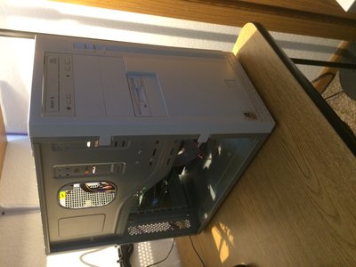

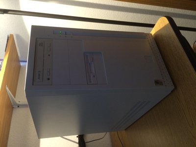

Reply 44 of 64, by Oldskoolmaniac
My build so far:
Acer 40x CDROM drive year: 99 price: ?
Mitsumi Floppy Drive year: ? price: ?
Nvidia Riva TnT2 32MB year: 99 price: ?
Intel Pentium III 800Mhz 100FSB Slot 1 year: 99 price: $851
384MB of RAM 3x128MB PC100 year: 99 price: I found a article awhile back saying 128MB RAM stick was around $600
30GB Quantum hard drive year: 9? price: ?
Fake Aureal Vortex 2 sound card, will be replacing with a real one soon
Intel 10/100 Compaq 3121 ethernet card year: 9? price: ?
Belkin 2 port usb 2.0 card will be replacing with a period correct usb 1.1 card soon
Intel 440bx/zx motherboard needs caps replaced bad year: 98 price: ?
power supply came with case all I know about the case is its a 90's case

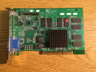

Reply 53 of 64, by Oldskoolmaniac
So my TnT2 crashes and glitches out when running in direct3d mode in unreal tournament and 3dmark it freezes half way. Im running the latest driver and DX9, that shouldnt be a problem cause i use dx9 and the other driver on other systems. I also have two TnT cards and tried both.

Reply 55 of 64, by Oldskoolmaniac
I think i was using the wrong driver, but i did a clean install of windows 98 and havent loaded the graphic driver yet at all and sometimes when i restart the computer i get corrupt vxd errors their is no option for sideband in the bios its an intel 440BX-2 motherboard.

Reply 56 of 64, by Oldskoolmaniac
This is the driver im using ForceWare Release 70 Version 71.84 no more artifacts on screen, but im stuck in windows mod and i only get 10fps, ut wont list direct3d for the card so i have to click show all renders.
Im starting to think the TnT2 is just a piece of crap, im prolly going to go with a voodoo3.

Reply 57 of 64, by brostenen
You are probably using too new nVidia drivers, and you should really consider using an older DirectX.
Try using nVidia driver version 28.32 and DirectX version 6 or 7.
Reply 58 of 64, by Oldskoolmaniac
I would try downgrading the driver but every time I install what I have I get an illegal error and im using dx6.1 it came with windows 98. When I run dxdiag test it closes out of the test half way through it.

Reply 59 of 64, by brostenen
I get that same error when using Win98se. I think the default version is incomplete or broken.
Installing DX7, seems to correct the error.
