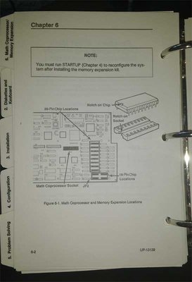

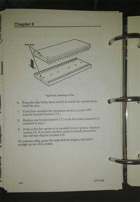

Reply 7 of 10, by brostenen
This is the complete Chaptor 6 in the manual.....
There is only 4 page's so I guess that I am missing some more in dept manual or something.
Hope this is at some help for you guys. 😀

Reply 9 of 10, by h-a-l-9000
Rank DOSBox Author
DOSBox Author
Guess:
20-pin are 44256 for 1MB.
18-pin are 4464 - to go from 512k to 640k, thus they should already be populated.
The soldered chips should be 16x 41256 for 512k.
Quite a mix 😀
