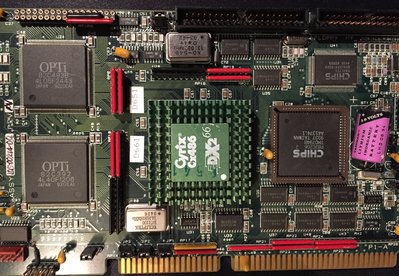

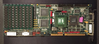

I have been testing a SBC I had in a drawer for a while. Finally got a ISA backplane for it, and it seems dead. 😠
Some things I've tested:
* Measuring voltage on the backplane (seems OK)
* Measuring voltage on the battery (dead)
* Tried some different jumpers on the card, especially one near the battery which may be CMOS reset. Looked after PC speaker header but haven't found any.
* Connected a floppy to see if it reads anything (it does not)

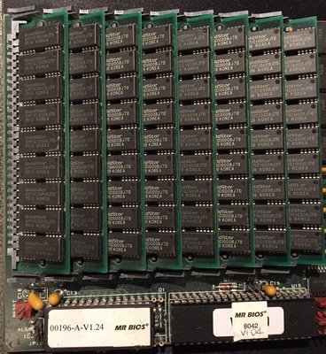

* Removed half the RAM and reseated all the modules
* Connected a LED to IDE HD header, no light though (-0.5V)
The backplane is a 8-slot backplane, I don't know if it matters what slot the SBC sits in, or what slot the graphics card sits in.
It's very difficult to find any information whatsoever about this card. On the back it is marked:
I-BUS 105-00210-00 REV C
D/D 105-00211-00 REV D
The only "clue" is one eBay listing with the same card, but with revision E. In the picture, that card had a jumper J10 set up in the corner near the jumper marked "reset". The pic is blurry, but I tried matching the jumpers. Nothing.
Any hints on what to try next is most appriciated!

I made some progress now, I measured directly on the ISA bus and saw that pin B3 (5V) was only about 4V. I had used 5V from a molex connector which was apparently a bad idea. I fixed that, and connected a PC speaker. I can hear sort of a faint click when I power it on, still no picture though.
What's worse is that I discovered that the OPTi 82C493B (chipset?) IC gets VERY hot immidiately on power-on. Maybe that IC is fried? 😢
The Cyrix CPU gets kind of lukewarm.

Do you have an ISA POST card? If there are any POST codes being broadcast then it would mean there's some life, it's just not managing to put anything on the screen. But the hot Opti chip doesn't sound good.
Is this happening at the instant you apply power, or is it happening some seconds later? If it's happening later then it might be a programmed beep, which means some code execution is taking place which would be encouraging. If it's happening at the moment you apply power it might just be electrical noise though.
Is there a datasheet out there for the Opti 493B chip? If so, you could try to find which pins provide the supply voltage and what that voltage is supposed to be. Odds are those ceramic caps next to the chip are in parallel with that supply, and could be used to measure that voltage while it's running. If you need to probe in a tight space, wrap tape around the probes.
I notice in the picture there are a couple of SIP components (one black, one red) plugged into a socket near the Opti chip. Have you been able to verify if those are installed correctly, or at least the same as the eBay listing you saw?

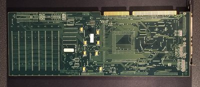

Good idea, there are tantalum caps nearby on the back of the card too.
I think this is a resistor pack, terminating the IDE bus or something? I honestly have no idea. They are not in the same place as the ebay listing.

The board is 5V only. If tantalum caps were shorted you would get the *bang*, smoke or no power symptoms.
The socket above the OPTI chip appears to be for a cache module (checking the pin assignment in the datasheet). Try to remove the SIL resistors.
Also, did you try to remove the SIMMS yet?
