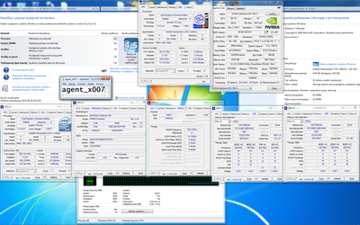

Reply 12 of 25, by agent_x007
My 2 cents :
1) Win XP/7 x86 can use up to 3,5GB of RAM without any patches.
2) A PCI-e GPU will map all of it's VRAM to 256MB physical adress space (at least I did not encounter a GPU that does less/more with PCI-e slot).
VRAM capacity is irrelevant (due to Virtual Adresses) : LINK.
3GB VRAM + 4GB RAM in Win XP x86 and it's Task Maneger shows "3668764kB" as usable RAM capacity (under "Pamięć Fizyczna" field).
I know, it must be "Black Magic" to some people when 3GB VRAM + 4GB RAM = ~6,5GB usable in total with Win XP 32-bit (no PAE patches) 😉
3) "Usable RAM" is highly dependant on hardware and BIOS configuration of PC.
Memory Hole/Memory Remap will help in adressing over 3GB+ mark with x86 Win OS'es.
Additional controllers/cards on the other hand, may add to memory reserved adress pool, because they simply need those adresses to work properly.
BIOS assignes adress space (most of the time) and if it get's it "wrong", user will lose some of the usable adress space in OS.
Little sidenote here - 32-bit only CPU (ie. without 64-bit support), can adress up to 3583MB (or ~3,5GB) of RAM, check attachments to this post for proof 😀 (again - without any kernel patches).
