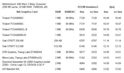

Reply 18 of 25, by feipoa
What was your L1 enabling strategy? What chipsets and graphic cards did you try?
Actually, I can get up to 14.99 fps if I use 0 ws. I am using the fastest PGA-132 board encountered - an AMI Mark V Baby Screamer based on the VLSI 330/331/332 chipset. This board has better DOOM scores, for example, than a SiS Rabbit (SiS 310/320/330), UMC 481/482, or PEAK/DM (Chips 351/355/356). I am also ensuring that L1 is properly enabled. The ISA bus is run at 10 MHz, which is the only option when a 40 Mhz CPU is installed in this board. It runs at 8 MHz with a 66 MHz osc. though.
As for the screen size, I am using whatever the default screen size is for the Doom demo benchmark. I think it is v1.9.
Click for larger, more readable view to see this board in action with different graphic cards. The GPUs make a big difference.

Thanks!
I used the tool from the "Make it 486" floppy which came with various SXL / SLC CPUs unless the board had native support. I used default settings so there might be some headroom.
But I have to admit I never has the VLSI / Intel licensed board. Still have to bench my Acer based board. It seems quite fast.
