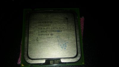

Well. I got a new CPU for the collection. The really high clocked Pentium 4 670 with it's 3.8 GHz
    1.44 MiB
    2624 views
    CPU

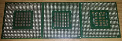

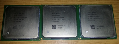

Three Pentium 4 amigos 😀
2.5 MiB
2536 views
2.55 MiB
2534 views
EE is marked underneath.
From the left :
Northwood rev. D1 (30 cap)
Gallatin rev. M0
Prescott rev. C0
