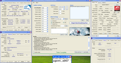

Reply 11 of 14, by agent_x007
SPBHM wrote:
Crysis on low is quite ugly but I think it only uses SM2.0, even a 9700 can run it, it might run well enough with the 6800 on low.
Indeed. But GPU is not the only thing you need to run Crysis 😀
And yes, GPU is overclocked a bit, but still - 1280x1024 on Low with almost 30 FPS avg. 😉

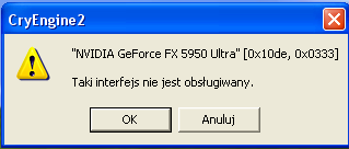

Reply 13 of 14, by agent_x007
Loose translation : This kind of GPU is not supported 😁
