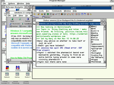

So..., I just received an Creative ES1371 Sound card (the chip is actually 1373) - I installed it - and tried the official driver from: 7501748.exe. No luck - the driver apparently installs - asks to restart computer but no file is copied or anything changed.
Then, I tried Watler's driver . http://turkeys4me.byethost4.com/programs/index.htm
Installation is simple enough: 1) copy crea1371.dll in Windows folder, 2) edit system.ini [drivers] wave=crea1371.dll - and ta da...! I was so convinced I have to fiddle around to hear a sound, but no... it worked at first restart... (and still works after another few restarts)
Now the bad part: sound will lag if I listen to an mp3 and move the mouse, it has some DJing effect... 😀) I don t think Ryzen 3900x is to blame for being to slow...

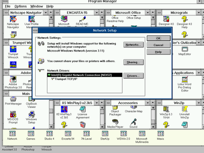

I know this is a very old thread but I want to report my experiences with some of the info showed here:
I own a Creative CT4810, with a much newer chip (CT2518) and I tried the same driver for ES1371 and as many others, it just installs and tells you that it will restart Windows and nothing happens. The installer has a Windrv.z file with the following content:
 - EAPCI.386
- EAPCI31.DRV
- EAPCI31.HLP
- MIDIMAP.CFG
- MSMIXMGR.DLL
Meanwhile, I had been able to make it work with the driver at http://turkeys4me.byethost4.com/programs/index.htm without problems, just changing the system.ini and copying the file, it doesn't even need to load the DOS driver with APINIT and APLOAD in Autoexec.bat.

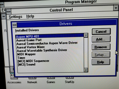

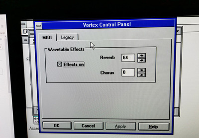

Reply 47 of 63, by OMORES
Stainlesscat wrote on 2021-12-06, 21:45:
Hi guys
i wanna add that the vortex 1 au8820 chipset has windows 3.1 drivers. they even work without relying on legacy dma features that other pci sounds require.
i attached the drivers to this post.
I downloaded this driver, and gave it a go with a Soyo 5EHM VIA MVP3/K6-2/500 - and it works*, both in DOS and Windows 3.11.
*I had to replace ASP4DOS.COM with a newer version from Windows 9x drivers. The included version [(C)1998] was causing a loopy blinking cursor in DOS 6.22. DOS "7" from Win95A bootdisk reported this as a divide overflow error.
Well, the general idea was that PCI sound cards in Windows 3.11 are a no go... But there are at least three options: ESS Solo, ALS4000 and AU8820. Probably the original Ensoniq ES1370 cards do work in Windows 3.11. Those from Creative - definitely do not work with Ensoniq drivers, but there are unofficial drivers.
Also some Crystal PCI sound cards do have Windows 3.1 drivers, but I haven't tested any.
This list might get bigger...

Reply 49 of 63, by OMORES

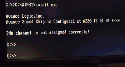

Rawit wrote on 2021-12-08, 08:12:
I found another ZIP with Aureal 8820 drivers with a slightly different file size. Not sure if it's another version.
I think there is only one version in the wild for Windows 3.11... ver. 3.1 from 4/29/1998 - I would gladly test any other version.
Unfortunately, this version doesn't work on newer motherboards - even if AU8820 works fine in DOS! So, there might be some chipset magic embedded into .386/.vxd driver files because AU8820 is recognized instantly on a VIA VMP3 motherboard, using a Windows 3.11 installation (with Aureal drivers) from another computer. But when the same drive is plugged on a newer motherboard I get the same error as if the card is not plugged in: "Couldn't get VxD API". I tested here several Intel/AMD motherboards in DOS with AU8820 and none of them is recognizing AU8820 in Windows 3.11.
    181.84 KiB
    2027 views

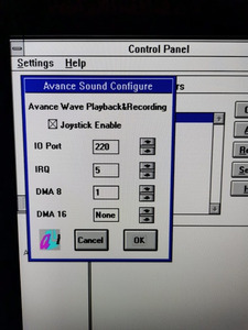

Reply 50 of 63, by Stainlesscat
OMORES wrote on 2021-12-08, 15:57:
i believe the reason why the windows driver fail to work because the driver code is not programmed to work with the aureal chipset behind an PCI bridge. which is similar how the 9x drivers throw an error talking about not being on the primary PCI bus, that error box "Couldn't get VxD API" is major sign of the side effects. Maybe it can work with a secret win.ini setting?, kinda like how the aureal win9x driver has an registry key that makes it ignore primary bus error.
the "ASP4DOS" TSR is it's own real mode DOS driver design to work independently from windows and then so has support for working with the sound card behind an PCI bridge and other unusual PCI Buses.
Although i could mistaken that error for something else, correct me if i'm wrong if this is something else entirely.
Btw i've got this sound card working in a Windows 3.11 KVM Virtual machine using PCI Passthrough on c602 chipset motherboard. I noticed the VM makes any device attached to it behave like it's on the primary bus of the VM, at least thats how windows 98 & Windows 2000 device manager sees it. "maybe the emulated 440fx & PIIX3 chipsets on QEMU maybe gives it support? idk really..."

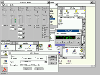

Hi, on what hardware are you running Win 3.1? Does it start in enhanced mode? If so, you don't have to make any changes to any file, just install drivers ( turkeys4me) from control panel and system.ini will be automatically modified. This lines will be added:
[drivers]
wave=CT137X.DLL
If you can get an original ES1370 from Ensoniq you can use their drivers and install the card even on very modern hardware, right now I'm using an Audio 3000 PCI with ES1370 on a Ryzen 3900X - and it works perfectly. (MIDI also)
