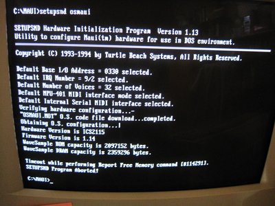

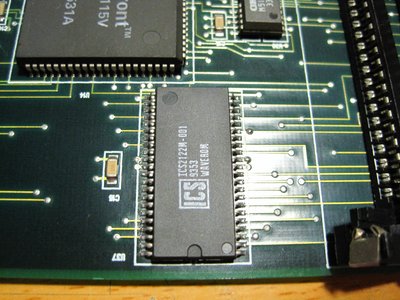

Hi, got this card to test from friend which I never used this card before and having issues understanding how to setup correctly.
The card is the Turtle Beach MAUI, settings are defaul, J2 all open (was like this, didn't change it misself), and only onboard ram (I think it as 2mb standard).
Downloaded the drivers from here at Vogons driver library, and installed the dos drivers in C:\MAUI.
The Setupsnd utility starts ok, detects all base adress, irq etc, but the samples are 0 used, all 512 free and ROM capacity is 0 bytes.
I get no sound in games selecting General Midi.
Do I really need to add ram to the card to work?
Any help is welcome 😀

Well, the program is unable to detect the onboard 2MB ROM, hence 0 samples in use. The card doesn't need any Simm module to run, it works well just with the onboard ROM.
You might try another driver version. Usually the driver of the Tropez card works well with the Maui. I had the best experience with the OSWF.MOT firmware. Download it and try again!

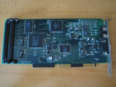

If I put some ram on the card (2 x 1mb) I get timeout errors everytime.
I guess theres hardware damage to the card, ROM or onboard RAM. 😢

Reply 3 of 20, by FGB

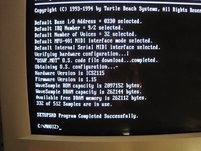

The good thing first: The sample ROM now gets detected! We get closer!
What are your system specs? Are there any other devices using similar addresses or interrupts? Remove any other sound related hardware first!
Follow these steps:
1. Make sure you make a clean boot without autoexec.bat and config.sys (Press F5 at startup). There is a chance that other programs are interfering.
2. Go to your directory and type SETUPSND OSMAUI.MOT and see if if fails again!
3. You can also try to clean the contacts of the card. Try again with No1!
4. Try the other firmware mentioned in my previous post. The latest OSWF.MOT is a 1.15 firmware. Download the firmware from the net and put it into your maui directory.
5. Type SETUPSND OSWF.MOT and see if it works now!
Good luck!
P.S: Would be a shame if this nice card is defective 🙁

Reply 4 of 20, by JLPedro
I will try with the clean dos boot and with the oswf.mot, there's no visible damage to the card and everything is clean.
If the problem is in the onboard ram or dead caps I can repair.
I have hope 😊
Reply 6 of 20, by JLPedro
And it works! 🤣
Bad solders in the ROM chip, a quick reflow of the solders and the card now configures correctly and plays 100%.
Using the OSWF.MOT firmware 1.15
Well it sounds great, very happy 😀

Reply 10 of 20, by FGB
I'm happy that your card works now. Maybe it was a cold solder joint. Seems to happen even on the high quality Turtle Beach boards.

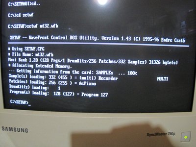

It CAN load patches in dos, I've managed to load a patch with MT-32 sounds and it plays very nicelly in games that support MT-32 but don't patch them (use the standard MT-32 instruments), tested Monkey Island 1 ,Risky Woods and 4d sports driving in MT-32 mode and sounds very much like the MT-32 😁 .
Again, games that alter the MT-32 and use extra patch/banks won't play correctly with this (Monkey Islands 2 does this, and many more), just games that use the standard MT-32 instruments.
I guess that with enough ram in the TB Maui other WFB files can be loaded (needs testing)
Just set the card normaly with "setupsnd wfos2001.mot" and then "setwf mt32.wfb".
I've attached the files needed.

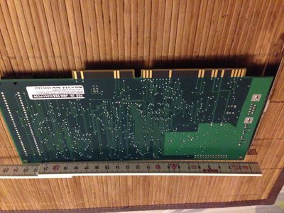

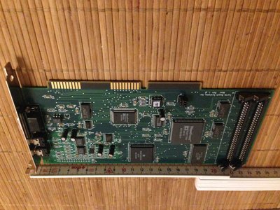

The length of the card from the edge of the PCB to the edge of the slot bracket measures 23,5cm or 235mm.
