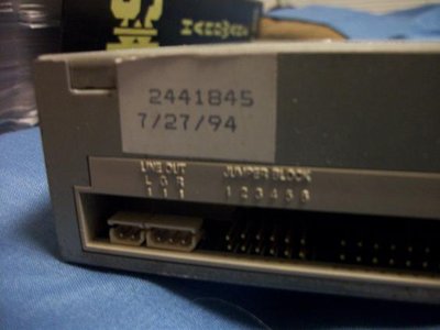

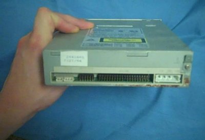

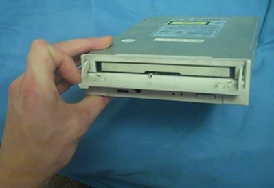

I've had this drive for 4 years just laying around. It is a 2x speed drive. I see the same looking drive in Gateway 2000 systems such as the P5-100. Model is Nec CDR-260. Manufactured April 1994. The drive tray does open despite some rust on the back of the drive. I plugged it into several newer motherboards like SS7 or S370 but did not work. This makes me believe it could be one of those pre-ide drives that were attached to Creative ISA SB16 sound cards with the CD interface.

Reply 3 of 18, by Robin4
Whats written on the back above the controller connector: `BUS` or Interface.
If its BUS then its one of the early proprietary ones. If its `Interface` It could be one of the earlier IDE drives.
I see that the drive uses the old style of molex and also year 1994 saying that it could be an older proprietary drive.
Those older drives dont work on an normal IDE interface.. So it wouldnt death after all..

If you look at the back pic, the drive does not have CS/SL/MA jumpers. It has 6 unnamed jumpers in place.

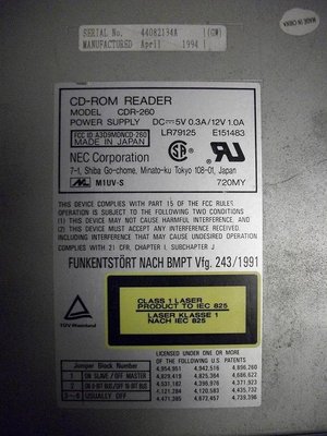

Here we go folks: pics of the drive:

Reply 12 of 18, by Jo22
Interesting, the label also shows an 8/16bit jumper setting.

The 8-bit / 16-bit settings is only when you using an non music card, but a seperate CD ROM I/O controller interface board..
When this interface board is 8-bit you need to set this drive to 8-bit operating mode.. If this controller is a 16-bit one, it needs to set to 16-bit on the drive as well.. Its straightforward.

I insist on trying to get it to work before I trash it... It can't be ordinary IDE ATAPI due to it having SIX rear jumpers. BTW they used to ship proprietary drives with creative sound cards back in the day. Like I said I believe it came out of an old Gateway P5-100 case when I received that with a bunch of other computers and parts years ago.
