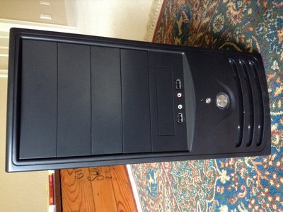

Reply 144 of 189, by Jupiter-18
My case has arrived!! I have more photos if anyone wants them.
This is different than the case I linked to previously. This one has a 500w PSU as opposed to a 450w.
Next up: MOTHERBOARD!

Reply 145 of 189, by Jupiter-18
So, The Gigabyte GA-5AX is currently on the back burner. I'm considering instead these two:
http://www.ebay.com/itm/ECS-P5VP-A-Super-Sock … k-/252384871474?
http://www.ebay.com/itm/EFA-P5MVP3-AT-Super-S … 5YCGqZ#viTabs_0
Thoughts?
Reply 146 of 189, by Kodai
I'd go with the ECS simply for the convenience of the ATX form factor. If you've already got an AT and case and PSU, then either board is fine. It's just a pain in the behunkus to redrill and tap an ATX case to fit an AT board correctly.
Reply 147 of 189, by Jupiter-18
Yeah. The ECS is my choice. I'm only going with it since the seller of the GA-5AX isn't accepting offers at the moment, and I'm sick of waiting! 😁
I got the case, but then school happened, so I haven't had any time to get more parts. Going to get the mobo, CPU (AMD K6-III+ 450), RAM, and 1st GPU hopefully.
