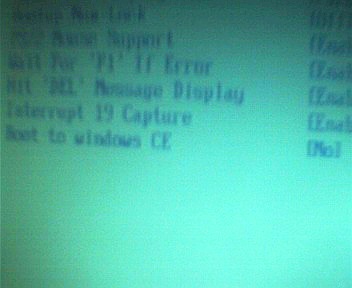

Reply 29 of 44, by Jo22
devius wrote:
So, it seems to me that these newer BIOSes only understand IDE, and not these older ST-506 interfaces. No idea why they bothered to include the ability to set the drive type to these older drives when the boards don't actually support them.
At this point, I think the only option for making it work on a non-XT compatible motherboard is to use a board that doesn't have any built-in IDE controller, which means a 486 era board at most, and only ISA or VLB at that, since PCI ones already have built-in IDE controllers.
MFM/RLL, ST506, ESDI, IDE or SCSI.. All this shouldn't really matter.
Afaik, AT sytle BIOSes do use any interface with an WD1003 compatible command set. These interfaces just have to be located at the right spot.
Just try yourself and put in an ISA Multi-I/O card, an AT-BUS HDD controller card or an WD1002 controller.
The system will accept them, aslong as there's no resource problem (make sure the corresponding on-board devices are disabled).
And in your case, it could also help to make sure the BIOS is configured to allow INT $19 for Option ROMs.
Not sure if this will solve all of your issues, but it's a start. You will still have to find out how to transfer your data.
