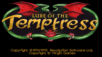

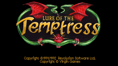

- Uploading the Windows binary and the diff patch. The algorithm now respects the aspect setting.
- This was required to play games whose native pixel aspect ratio is different from the one DOSBox assumes. Lure of the Temptress seems one of them.
